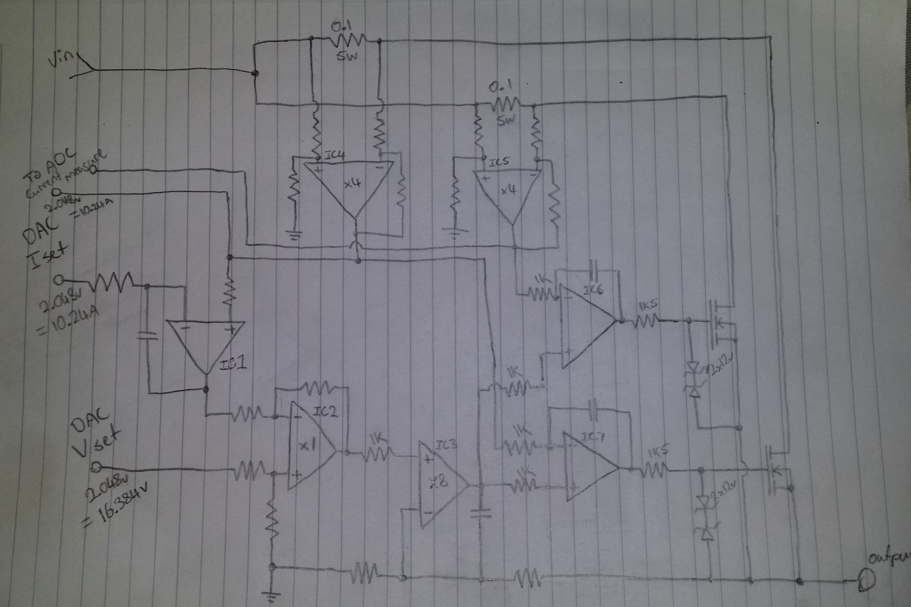

Hi guys I am in the process of making a constant current/constant voltage power supply controlled by a STM32F4 with a colour LCD touch screen.
I have already designed and made the control board and most other parts of the power supply and now I'm in the process of designing the high current output circuit. I am more of a digital person rather than analog and this is where I require the expertise of people smarter than I :)
Attached is what I have designed however due to my limited experience with analog electronics I don't know if this is a good way to do it. As far as I know I may have broken several cardinal sins and not even know it, however I am pretty sure it will work (to a degree).
I apologise for the 'old fashioned' schematic but we work with what we have :)
I forgot to write it on the schematic but the output is in the lower right of picture (obviously). In the final unit there will be 2 of these in parallel for 20A output. The current sharing between each will be done in software.
The gains will all be set manually (calibrated) with 25 turn trimpots, this is why I haven't added resistor values.
The DAC's are 12 bit (MCP4922) and have a precision, low noise 2.048v reference. The op-amps (AD822AN) are rail-to-rail but will likely be run from a -5v/+25v rails. The output MOSFETs are Exicon 10N20.
Please make any suggestions you can think of and if you need any more information please ask.
The bottom-left opamp seems to be comparing apples and oranges, since it has a current-dependent input and a voltage-dependent input? The output voltage of your supply will therefore depend on the current the load draws. Is that your intention?
You will need massive heatsinks for the output FETs ;).

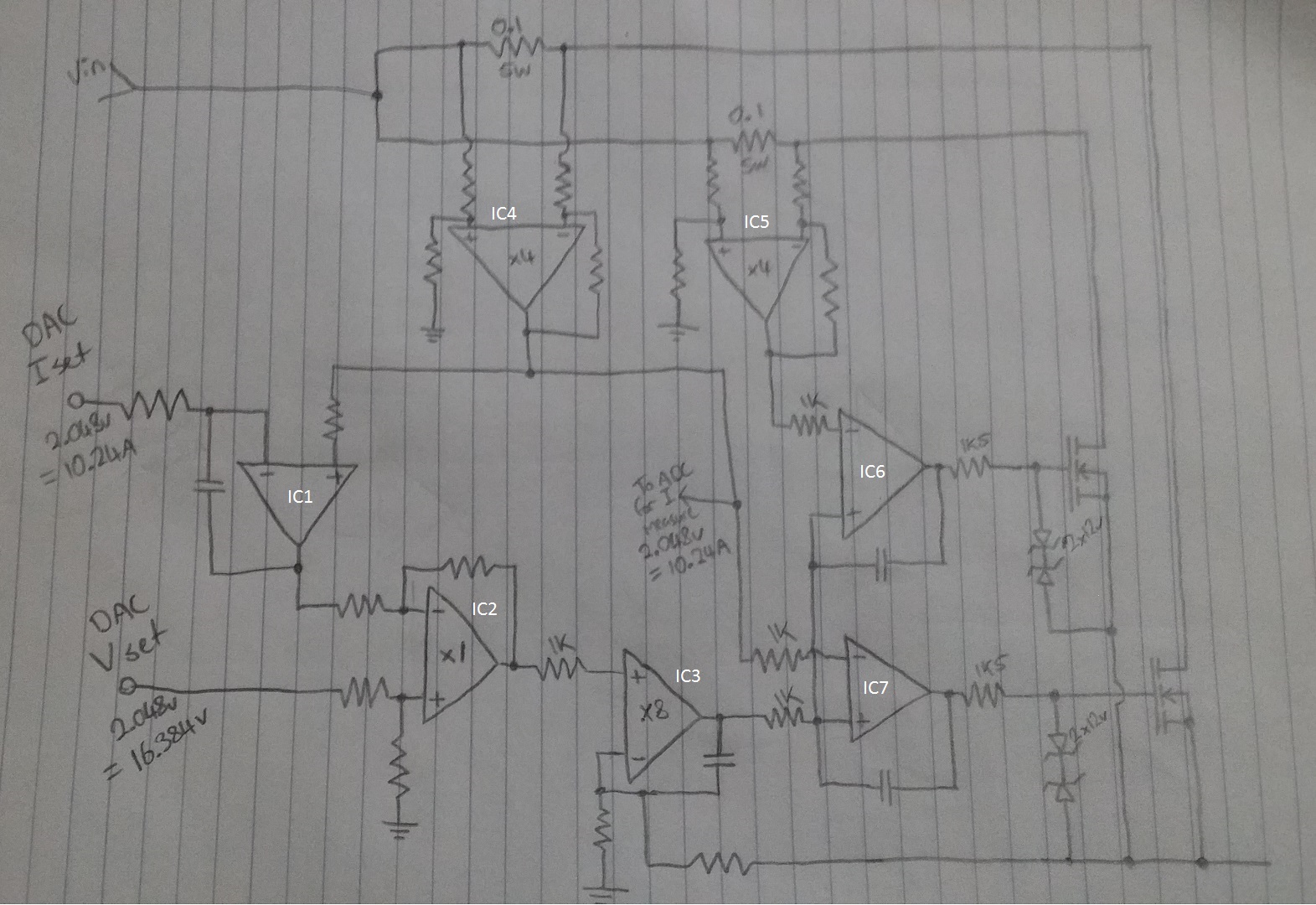

I re-uploaded the schematic with some labels to make it easier to discuss.
My thinking is:
Lets say that it is in constant voltage mode and the output of IC1 is zero. IC2 will amplify the difference between the output of IC1 and the DAC Vset voltage. While IC1's output is 0, then it will function as a follower until the Iset voltage is exceeded. Once this happens, IC1 will increase its output and therefore lowering the output of IC2 until the current limit is no longer exceeded.
IC3 should be regulating the output voltage with its negative feedback. It should give the correct voltage to IC6 and IC7 to keep the output voltage at the setting. IC6 and IC7 make sure that the current is shared between each MOSFET pair.
I understand that it can't regulate the output voltage with 0 output current. I may have to put a high value resistor on the output to make sure there is always some output current.
I'm still learning though but that is my thinking on what it does.
BTW I have a massive fan forced heatsink, 0.3°C/W rating :)
You need to calculate some real resistor values. You would have a really hard time adjusting so many trimpots in any sane way. Not to mention they are expensive.
I am inclined to worry about your dual paths of feeding input to your dual mosfets, A single current sensing resistor, amp and driver chain would be easier to understand and (more importantly) less to go wrong. Your dual path is inherently un-balanced since only one of the sense amps is in the control loop. You might be able to set it up perfectly to start with, but with half your output circuit out of the V/I setting loop, you are bound to have problems.
But don't pay too much attention to me, I don't know much ;)
Hi thanks for your thoughts.
I don't mind spending a couple of hours calibrating it all once it is set up. It will be easy enough to disable nodes and calibrate it all separately. I already have the trimpots so the cost isn't a factor. If however trimpots have a worse temperature coefficient, or some other issue I would have to consider.
As far as the current sharing goes, IC6 and IC7 control the current in each MOSFET, and both of those have a single input, being the output of IC3. If they are doing their job properly, then the current should be the same through each sense resistor, and I should have to only measure one for the current limiting.
Maybe I would be better off eliminating IC1 and IC2 and doing current limiting in software? I don't think this would have the same performance though.

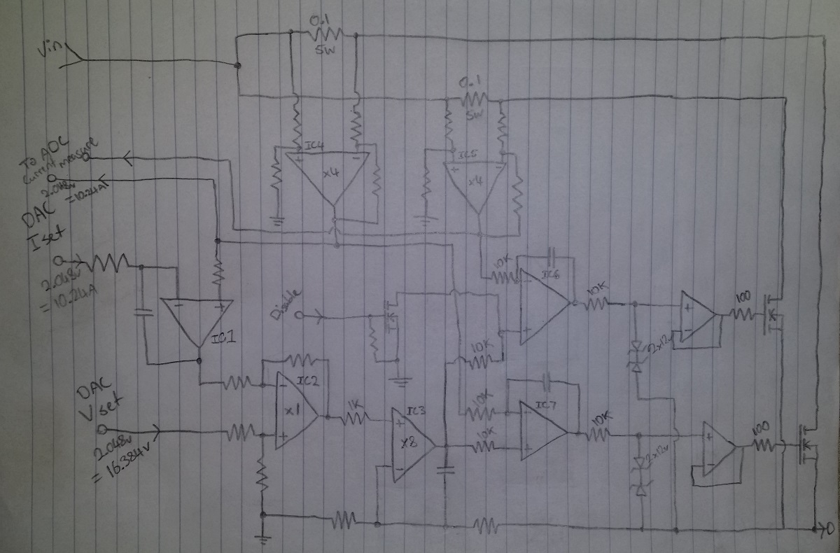

I have made some changes to the original schematic, mainly for neatness but also to fix an error with the non-inverting input of IC6. Once again I apologise for the primitive schematic.

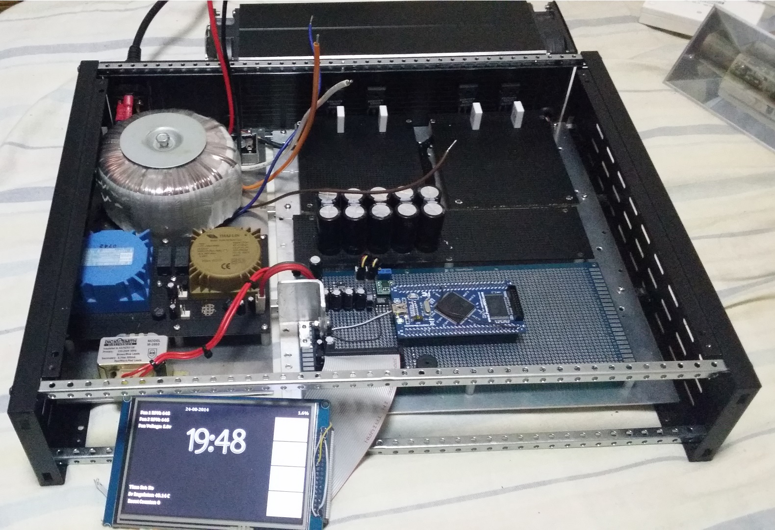

Also, here's what I have so far:
So far I have just done the basic power supplies and the control board. For the front I have a 5" 800 * 480 touch screen. The board is an STM32F4 from ebay. It has 1MB of SRAM, 128MB of NAND flash and 16MB of NOR.
It has a DS1302 onboard for timekeeping and a bit of battery backed RAM. I am controlling the fans with a linear voltage and measuring the RPM also. It will have temperature sensors on the 5v regulator, the main bridge rectifier, the output MOSFETs and/or the heatsink.
Total overkill for a power supply but most of this stuff I had laying around and decided to put it to a practical use.

That's some impressive kit you have there, BTW. What are the blue and brown things?

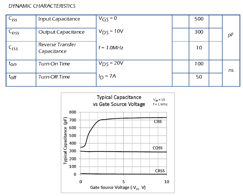

With regard to gate capacitance, would that be "input capacitance" in the data sheet?

They're potted pcb mount toroidals. Because of what I had laying around I have a transformer for the fans, a transformer for the 5v supply, and a transformer for the op-amp supply.

Yes, input capacitance.

I kinda like that case. Was it part of your junkbox or do you know the company that made it?

The case I bought from jaycar here in Australia. **broken link removed**
They don't say a manufacturer and I don't remember if it was written on the box it came in. Very good quality case though. There is also a 3mm aluminium front panel which isn't in the photo because I haven't cut or drilled it yet. It does come with handles but I don't think I will use them.
I have used the same case for a stereo amplifier before, and I do have a matching 1U case which I have yet to put to good use.
There is also a shop over here called Altronics which sells quite a lot of 19" rack stuff. Not sure if you have either of these where you are though.
