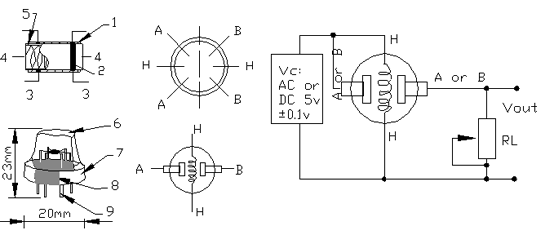

Hi All,
I am designing a circuit that detects the CO in the air.
I bought the carbon monoxyde sensor called (MQ 307 hanwei manufacturer) but unfortunately i didn't find on the net any docs related to it.
i ve just found the datasheet which didn't help me too much analysing its operation sad.gif
All the docs i found are related to figaro sensor that have 4 pins while mine has 3 pins
Please can anyone help
Thanks in advance

I assume this is the sensor you got.
Look here for the info on pins: **broken link removed**
And example circuits
Your device actually has 4 pins (kind of) but either pin A or pin B is connected to one end of the heater coil (pin 3)
See the attatched images
Hope this is of some help to you

From what i can gather, you need to power the heater with 5V (either DC or AC) and the voltage between pins 2 and 3 will alter depending on the level of CO(carbon monoxide) in the air. Though I'm not 100% sure of this. The variable resistor it shows is used to adjust sensitivity.
The supply voltage needs to be accurate (to within 0.1V) I'd guess you'll be using DC power source because it's probably more convenient for this, and I'd recommend a voltage regulator (7805 or similar) in which case you need a supply voltage of at least 7V

So you need 'a low temerature' to detect CO and a 'high temerature' to detect methane. I guess you need to power the heater with 0.2V for the low temp.
Looking at the test circuit, pin 1 is common ground for both the test and heater voltage, pin 2 is the sensor output, and pin3 is the +v for the heater.
Test voltage=5v
If you take a 5v supply, connect the negative to pin 1. connect +0.2v to pin 3, and connect load resistance between pin 2 and +5V, the voltage across the load resistance will alter depending on the level of CO.
If you did the same, but with a supply of +0.9V to pin 3, then the voltage across the load would alter depending on the level of Methane.
I "THINK" that's how it would work, though It will only let me view part of the data sheet.
