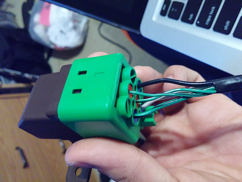

And speaking of "one touch", I have a few from Ford (Mondeo perhaps) as i was planning to do the "one touch" even with my previous setup (the spal electric motors).
They are these:
118614
Although I have seen those relays been used in "one touch" retrofitting to other cars, I haven't found yet the correct pin-out. There are models that have 4 wires and models, like the one shown which I have, that have 5 wires.
I have looked in various places (even ford forums) but with no clear answer as to what each wire represent or possibly a connection diagram.
Any ideas?

As it happens I do have the full electrical diagrams for a Mondeo (I drive one)..
When I have a bit more time I'll see if I can look up the window system wiring.
Thanks a lot mate. I'll be looking forward for diagrams when it is handy for you
