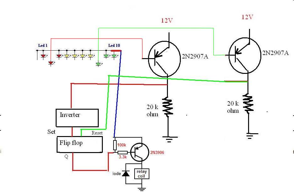

The problem is that both the SET and RESET inputs are high when LED 2 and 7 are both off. Assuming you want the relay off when LED 2 goes off, then you want the RESET input to be low and the SET input high. Thus connect the SET input (pin 6) to LED 2. Then connect LED 7 through an inverter to the RESET input (pin 4). That way the relay will turn off when LED 2 turns off and will turn back on when LED 7 lights.
If you do a truth table you'll see how it works. Remember that the logic level is low from the LEDs when they are on and the relay is on when the Q1 output is low.
The inverter function can be performed by a CMOS circuit such as a CD4069.
An 2N3904 or 2N2222 NPN transistor with a pair of resistors works as well as an inverter. Pins 7 through 11 of the 4013 should be grounded. A Darlington transistor could eliminate the relay requirement and drive the LEDs directly.

Yes, I forgot that the voltage only changes a couple volts (the 1.8V LED forward voltage you measured) at the LM3914 output since it is current regulated. The easiest way to convert this signal to give a 0 to 12V logic signal is to use an PNP transistor such as 2N2907A, the emitter connected to 12V, the base connected in series with the LED anode (the LED current will go through the transistor base-emitter junction) and a 10k to 20k load resistor from the collector to common. You will need one transistor for each LED you monitor (two in this case).
This transistor output will be near 12V when the LED is ON and 0V when the LED is OFF, thus the logic is inverted from our previous setup. Therefore the transistor collector output connected to LED 2 should be connected through the inverter to the FF SET input, and the transistor output connected to LED 7 should be connected the the FF RESET input.
Hope that does it for you.
Hi crutchow,
what are u talking is like this?
