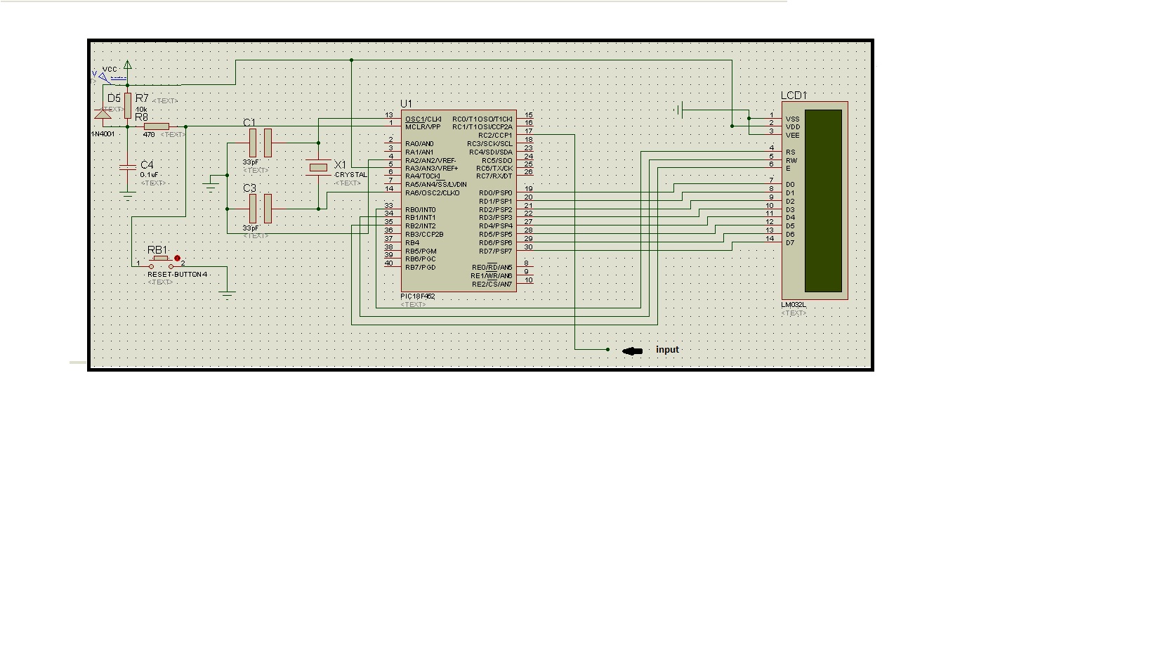

Hi guys , I am trying to measures the period and the high time of rectangular waveform using capture mode and display them on a 2x16 lcd . I am using ccp1 as input .
But although the program is build succeeded the screen doesn’t display anything .
I am working with pic18f452 and pic18f4520 I use mplap ide v8.63 and c18 lite v3,36.
The period of the waveform can be adjusted between 1,5ms and 3ms and it is between 3 and 5 volts .
This is the code I’m working on .

I know this subject is been discussed again but I am stuck here for more than two weeks and I have try anything I can think. i have add the diagram of my circuit

Firstly... You can't use OpenXLCD(); twice.... This should be once in the main routine... before while(1);
Secondly... The XLCD header is set up for 4 bit interface on PORTB... You need to change this...
Ian Rogers thanks for the answer i will move openXlcd the main .I think i have set ok the xlcd.h as for the program <magvitron> add i will try to understand and changed it but I'm not sure if i can

i try to modify my program but steel the screen doesn't display anything not even the words
<<this is thigh>>
If i program pic18f452 just to display some small phrases it works fine but now i can just see cursor in the begging of first line.
this is my code now :

i think  i have added   all the source file  that  the c18  functions need  to work.(cp1close,cp1open, cp1read,t1open,t1write)  and for lcd ( wcmdxlcd,putsxlcd,openxlcd,busyxlcd)
please help me .
Thank you.

I don't have time to check your code but I suspect your interrupt as you don't specify an address. See example 6 & 7 in this document for more details. Also, your comment states internal osc but your config is for a crystal.
my circuit have 20MHz crystal oscillator connected on osc1 ,osc2 should i set the timer 1 as external source?
Hi guys. I finally managed measure and display on the 2x16 LCD the period and Thigh time of rectangular waveform.
My problem now is that duty cycle doesn’t display on screen .
The duty cycle (DC=thigh/Total ) is a decimal number . This is code
