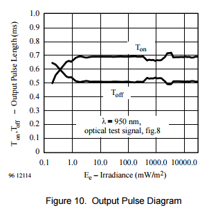

I believe you are discussing the change in pulse with and spacing with distance:
as shown on the left of this graph. Methods that depend on accurate pulse or space widths will be prone to problems, because those widths are not very reproducible (as just mentioned by hexreader). One way around that is to use a coding scheme that does not depend on pulse width, but rather on a transition, such as Manchester coding. If you search ETO for Manchester you will get lots of hits. Or, just search Google. There are other methods of coding, but Manchester is a common keyword to search.
