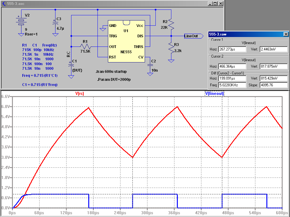

How about a 555 as an astable oscillator. If you have an oscilloscope, or frequency counter, the frequency of oscillation is a direct function of the unknown capacitance.

Does your computer have a sound card? There is free frequency counter software that will count the freq applied to the LINE input as long as that frequency is between ~20Hz and 20,000Hz. The 555 oscillator circuit I mentioned can be calibrated to produce an frequency in that range.
Please, please, post the circuit diagram of the circuit you are suggesting.
I would be very thankful to you for that. and thanks for the help you have given till now.
Yep, I have a sound card, but I would not like to carry my computer or my caps everywhere to measure them, and is it safe to put external currents into a computer(it may get damaged)?

Here is the 555 oscillator. If substituting for R1, keep it between 10K and 1Meg. Try to keep the oscillator frequency between 20Hz and 20Khz. Use a shielded RCA jack audio cable to go the Line-IN (either channel) on the computer. It will not damage the sound card. Herei s some sample software.
