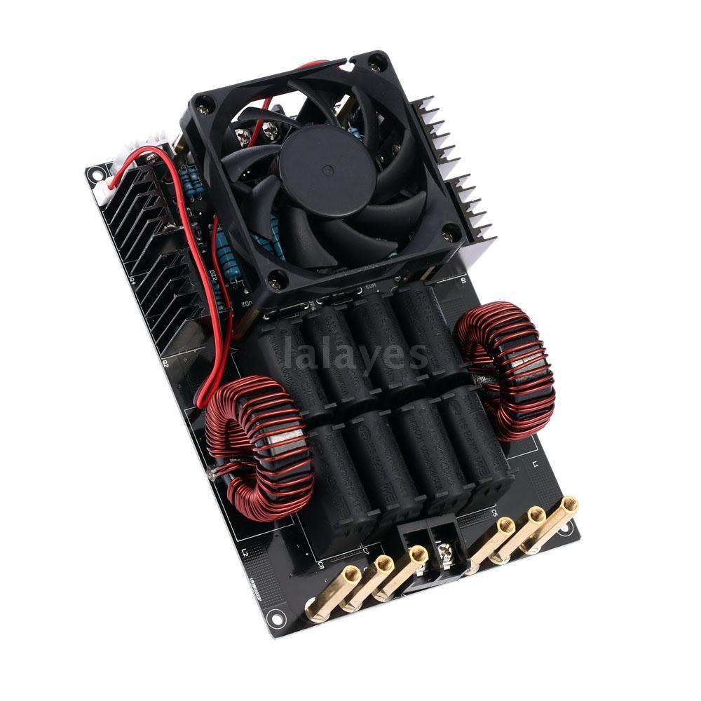

However, can whatever load is connected to the batteries tolerate the ripple from the transformer/rectifier?
JimB, That I don't know, it is a Induction heater module, it draws a lot of current and the higher the voltage the more it draws, up to 50A at 40V. I was thinking that the batteries would smooth out the ripples to a certain extent, but wanted the capacitor just in case it they didn't.

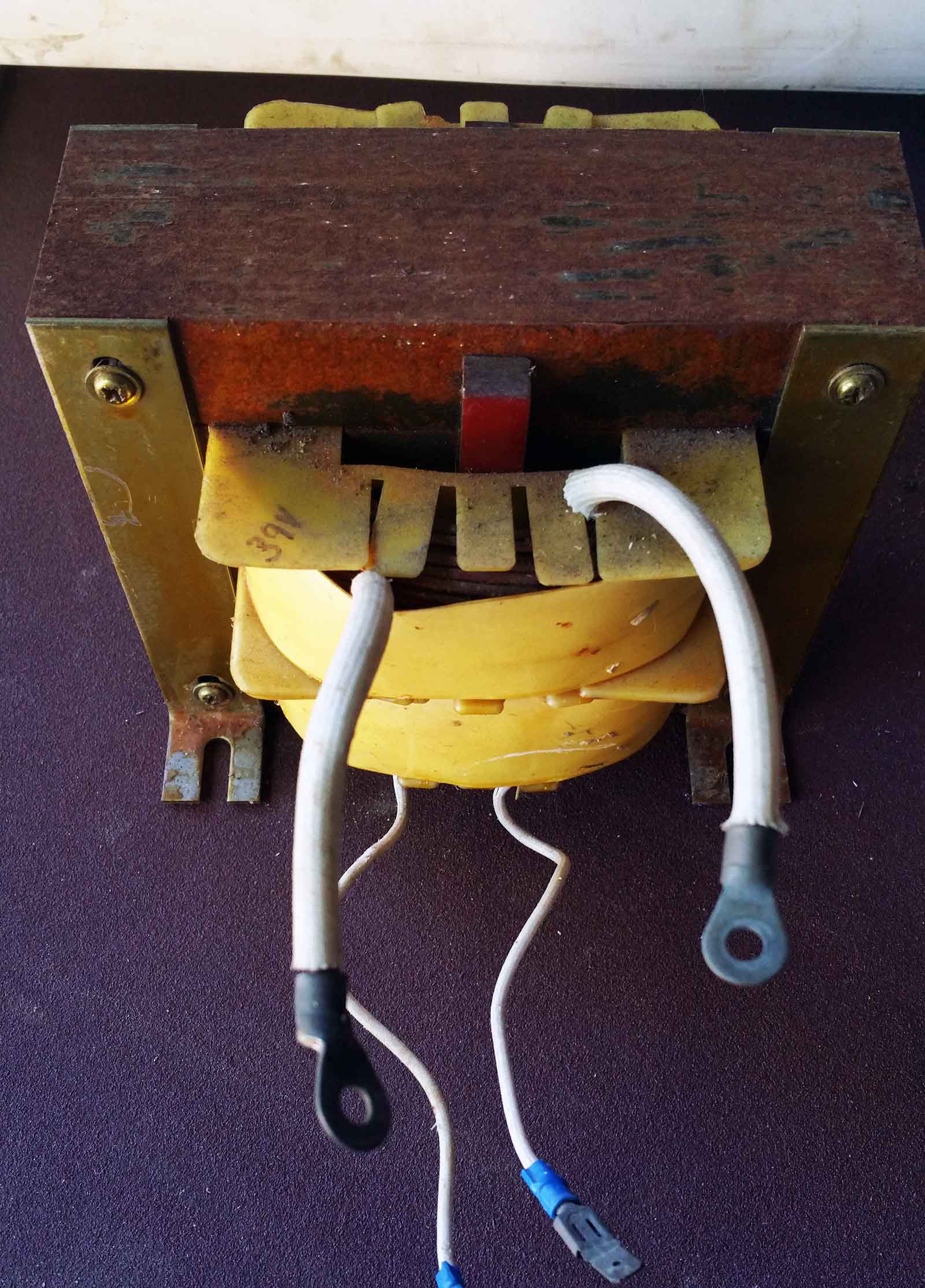

Hi "Spec",
2) I am not sure what the amp output of the transformer is, it is 16cm W x 13cm D x 14cm H, and weighs 9.7Kg.
3) I just want to "top" up the batteries during the discharge only.
4) 10 min is more than enough time for the heater to do it's job so with the transformer top up it should be enough time not to discharge too deeply, I hope.
5) There are three batteries in series so total of 18aH capacity @ 36V
6) The batteries are UPS AGM type, once the heater has done it's job then I can individually charge the batteries to full with my 4 stage battery charger or just leave the transformer attached. But I am not sure what the extra voltage will do to the 3 batteries, although I measured the output with no load but I just don't know what the voltage will drop down to once connected to the batteries and or the heater.
That is a serious transformer and I would guess that it would be capable of delivering a 10A charge into the three batteries. For the time being assume that figure is correct.

Just one more question that needs to be asked: what is the maximum input voltage that the induction heater can take?
From what you say, I imagine that we can sort your transformer charging quite simply, possibly by using just the transformer, bridge rectifier, and a power resistor.:)

The batteries are Powersonic brand PS-12180 NB 12V 18aH
The induction heater works from 12-40V, here is a direct cut and paste from a sales page on E-Bay.
Features:
The DC power supply voltage is 12V~40V.
Recommended input voltage range DC 24V~36V.
Maximum input current 50A (short), Maximum power 1000W.
Equipped with a fan.
High quality module board for induction heating machine.
Notice:
When used in heating supply power must be large enough!
24V power above the recommended maximum current of 20A.
12V power supply maximum current must be more than 10A.
Specifications:
Power Supply: DC 12V~40V
Max. Current: 50A
Max. Power: 1000W
The only must have spec is that the amperage must be instantly available from the time the module is switched on otherwise it won't be able to resonate the current through the looped copper coil and build up the large magnetic field, which is why I am using the batteries.
