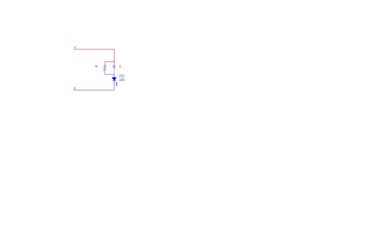

In the attached circuit LED represents a series parallel combination of LEDs with series resistances which require 12V, 300mA. To drive it from full wave rectified 230V AC (applied between A abd B), can I use a series capacitor to control the current through my LED load? If so, how to select the type and value of the capacitor ?

You can't use a capacitor to limit current once it has been rectified.

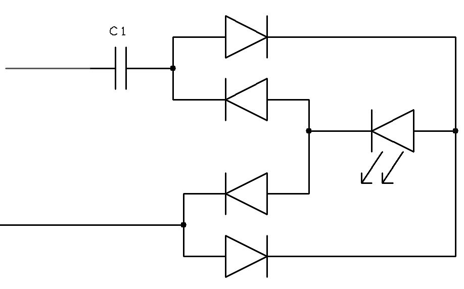

What you can do is put a capacitor in series with AC to limit the current, and rectify afterwards. It won't isolate from the mains, you need a capacitor rated to the full mains voltage (1.4142 times the rms) and the current depends on the supply voltage, frequency and the capacitor tolerance.
However, 12V and 300 mA is a lot for this sort of power supply. Also, the current though the capacitor will not be reduced with the addition of a small resistor, so you would be better to put all the LEDs in series so that the overall current is less. It is a good idea to put some resistance in series with the capacitor to reduce the in-rush current.
The impedance of the capacitor is 1/ωC where ω is 2πF so it is 314 for 50 Hz
For 300mA the capacitor needs to have an impedance of 240/.3 = 800Ω
So C needs to be about 4 µF. You can get capacitors of that size, rated to 250 V or more. They are called "motor start capacitors".
However, they are larger and more expensive than a small transformer that would supply 300 mA at 12 V.
I wouldn't use a series capacitor as a current limit unless the current is 50 mA or less.

You need to put a diode across the LED to protect the LED from reverse breakdown during the negative half cycle of the AC waveform.
If you put the LED's in two separate strings facing the opposite direction they'll act like a rectifier, one string will protect the other from reverse over voltage.
