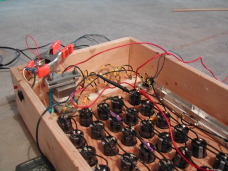

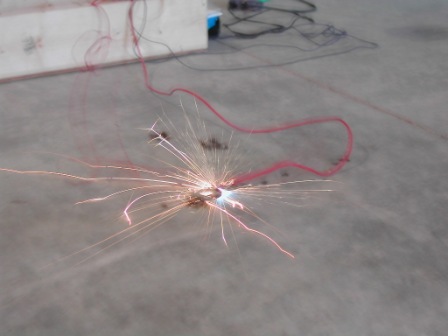

awright
Alright I finally got around to posting some pictures. Nothing spectacular, but it is interesting :lol:.

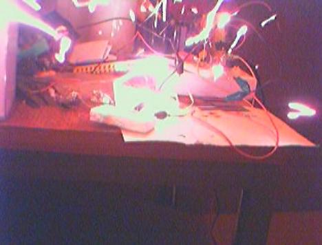

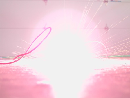

Also try shorting it acros an thin pice of coper or iron wire.
In my case the wire exploded in a very bright flash.(You beter not look at it wen fired)
I tryed to put it in an box an a small pice of paper on top.The paper got lifted about 2 cm.
Here are some photos.
This is just after fireing.The flash totaly blinds the camera(whole screen goes white) so i rater post pohots of pices of hot wire flying around.
1st pic is thin coper wire and the 2nd is alu foil (seams to give an longer lasting flash).
