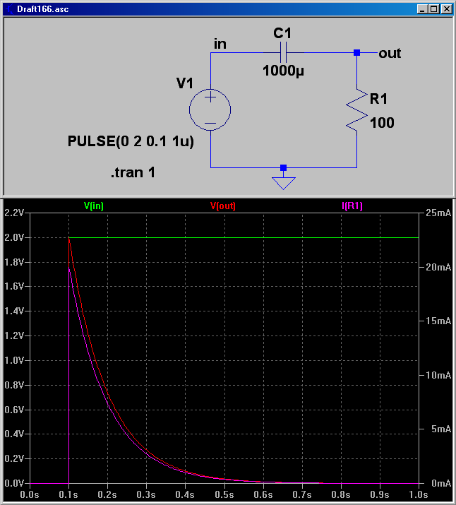

Look at these two simulations: They should help you visualize what is going on.
In the first one, a 2V step is applied to the coupling capacitor. Current flows until the capacitor is charged to 2V. The current decays from 20mA to near zero in the classic exponential way.

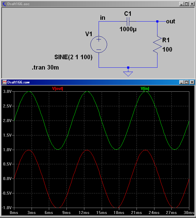

In the second one, a 1Vp-p 100Hz sine wave rides on top of a 2V dc level. The sim begins after the capacitor is already charged to 2V, which means that V(out) is just the peak to peak AC component (the DC component has been blocked by the capacitor).
