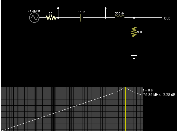

series R+ shunt C is low pass, series C + shunt R is high pass and series LC is band pass in series with the right load and source.

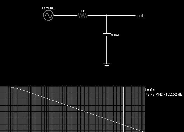

Not sure what you understand but a 0.1uF is almost a short circuit at 72MHz.
Notice the rolloff attenuation is -122 dB
Why are you feeding the very high frequency of 72MHz into the voltage divider designed for the very low frequency of only 50Hz?????
The capacitor value is WAY TOO HIGH for 72MHz and 30k ohms.
You forgot to say the attenuated level you want the output signal to be. For the 72MHz 3.3Vp-p signal to be reduced to 3.3uVp-p with the 30k resistor then the capacitor must be 0.074uF. 3.3uV is a very very low level.

Unless explicitly stated to be a non-inductive design, carbon film resistors are spiral cut and therefore have a significant inductance at 72 MHz. We still have not seen a schematic of your actual circuit, or a sketch of the test instrument connections. Without those, we're all just guessing.
