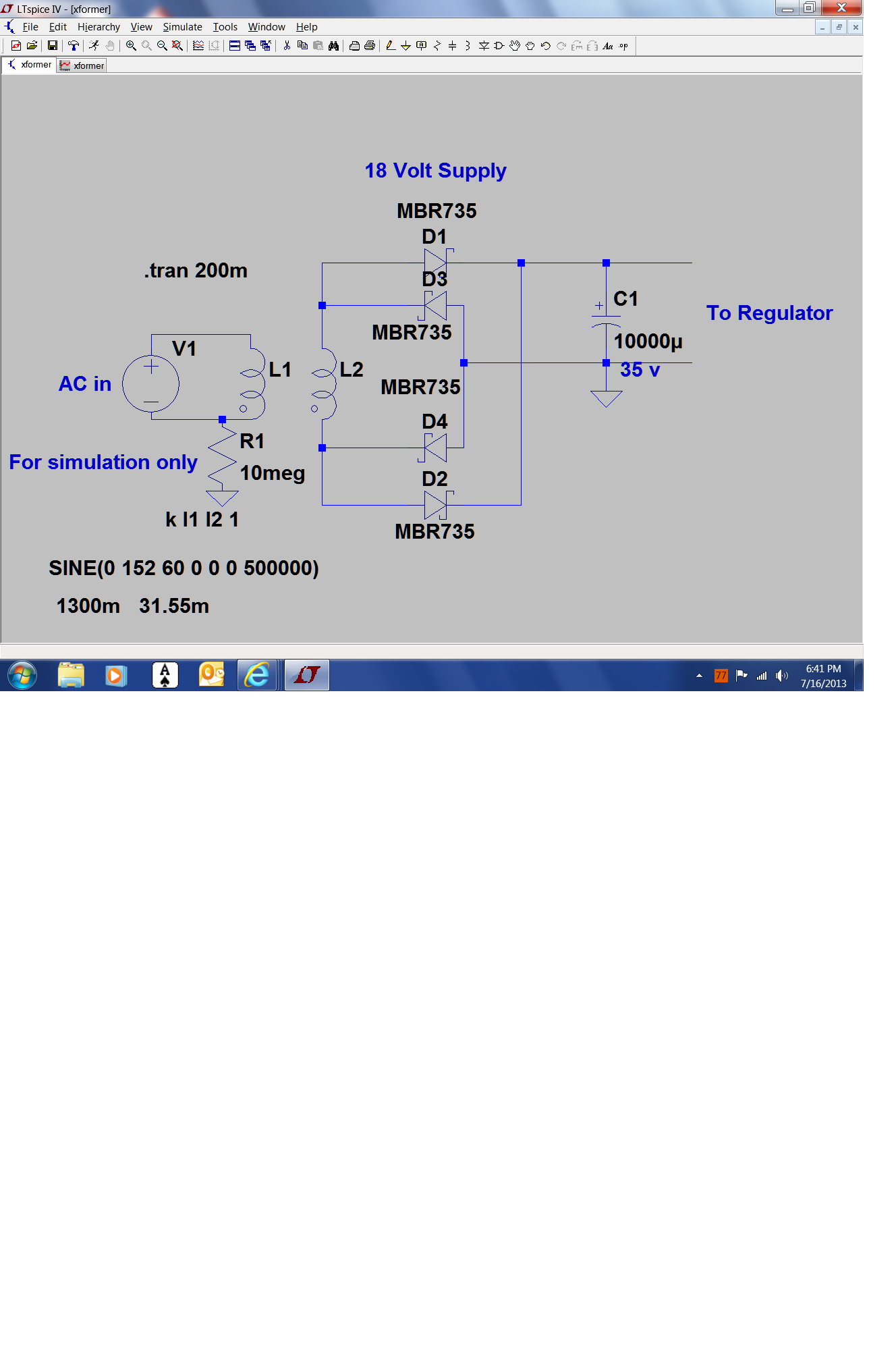

Hi There,
This is Ash I am new to this forum and electronics. I have a questions about connecting a capacitor in parallel to a bridge rectifier
I require 18VDC constant supply for my circuit and the current rating would be 4Amps. My transformed is supply is 18VAC coming from 400VAC primary transformer 90VA output
Is this capacitor connected at DC side filtering capacitor? Do I need a resistor to be connected in parallel to the capacitor.
Can anyone help with value of filtering capacitor, a resistor and to keep the DC Voltage at 18VDC with load and No load

Buy one of these little guys:
Then make your supply like the attachment.
Be careful with your transformer. It is a little underrated for 4 amps. Make sure it doesn't get too hot.
