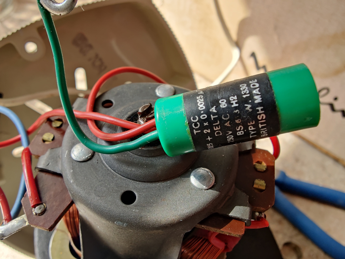

I have a capacitor I need to replace, but it's an old "TCC" type. So a few quick questions:
- Can I replace this with a modern suppression capacitor? This capacitor does seem to have some sort of earth connector.
It's a pretty standard 25micro farad rated for mains.
- What sort should I go for?
I enclose an image to help with the brain work.
cheers!
Pete - forum newbie.

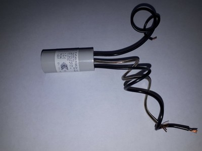

That is a "Delta capacitor" - three safety-rated (Class Y & Class X) capacitors encapsulated together.
There is a similar one listed on ebay here; you can see the internal arrangement of the three capacitors:
These have a similar function, but a newer design and somewhat cheaper - you would just have to join flying leads to one:

Thanks for your comprehensive reply rjenkinsgb! That's just what I need. I have some leads connecting the old one, so a re-connection is no problem.
