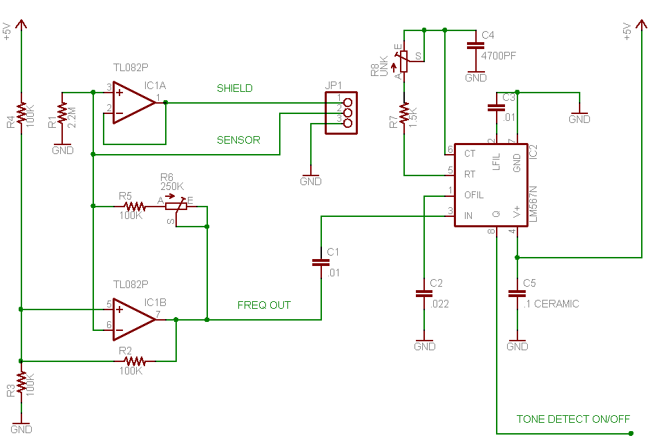

Nevertheless, here is a cross section of a sensor I made and the schematic. One down side is it might be too sensitive for your use.

Capaciflector.pngView attachment CAPACIFLECTOR2.pdf
With regards to the capaciflector, you are right. For my application it is a little too sensitive as I only need it to operate across a broad spectrum. Since I am using a PIC 16F877A to collect and convert the data, Roman Black's model looks perfect for me. It will only require changing the code for the microcontroller to recognise a different microcontroller target.
