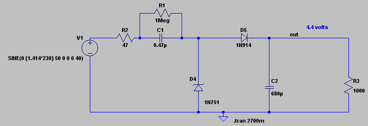

Is it ok to swap Live wire & Neutral wire in this circuit?I'm powering this circuit from a lamp holder.So it has no any direction.

The quick answer is yes it is ok.
Just be aware of which bits are live and which are neutral, make sure that you or anyone else does not touch it when it is energised and it will be fine.
I am sure that you are experienced enough to know that already.
Several comments.
Line and Neutral wires can be exchanged with out a problem.
Another internet schematic that will not work! R2 is in the wrong place!
R1, R3 must be a high voltage resistor or several in series.
D1, D2 do not need to be the high voltage 1N4007 but could be the low voltage 1N4001.
R3 is to find "zero crossing" information BUT I think this same information can be found at node C1,D1,
D2, (but at a much lower voltage) About 5 volts so a 10k resistor will also work. I have not tried it but I could if you want.
Just tried it and you get a 5V signal where the "edges" happen at the peaks of the line voltage. (not at the "zero crossing")
I moved R2 to get it out of the high current path of X1 60W.
There are several parts that don't need to be there. Do you want a simple version?

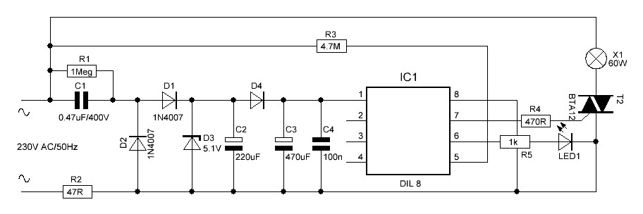

hi ron thanks for the circuits.you are correct.I placed the R2 @ wrong place.
regarding the low voltage zero cross detector.can it give signals on zero cross?I need to detect zero cross, not the peak of the waveform.
Hi ron
I'm bit of scared about the last circuit.because the zenner is mostly busy on both AC cycles.I like to stick with the design on your post number 4.But the zerocross I moved to hot wire.
I need to consider the circuit more robust.I added a MOV 275V to parallel live and neutral.Does it give a circuit protection without a fuse?I have a limited pcb space.
Regarding the hot wire sensing zerocross,
Will the lightneing strike pass through easily from this zerocross resistor?

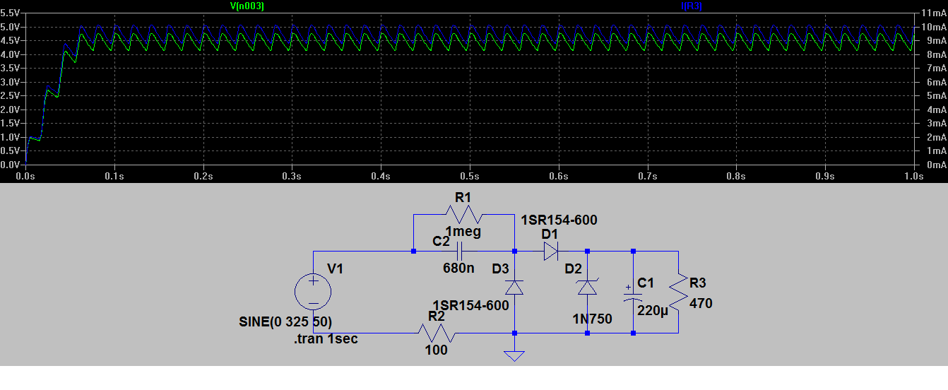

Hi I have a simulation problem.The current this circuit will producing is very low.Or my simulation is wrong.Because I need to find a commonly available triac with adequate gate current.
What is the current through D2?
Hi actually I don't know the current.Attached the LTspice sim.I'm going to use BTB04 Triac. From this supply my load will be PIC, BTB04 triac & a RED LED.
  • AC Sim.zip
Supply is about 9mA.
The BTB04 is no longer in production at ST. Needs 10mA in Q1/Q3/Q4. I am not good with triacs! What about Q2?
Does the red LED have to be on while the triac is on?
>If the triac needs 10mA and the LED needs 10mA but they are exclusive to each other, then there is a chance.
>Is the LED switched on/off? or does it stay on all the time? (all the time .... I have a way that does not load the supply)
> Do you drive the gate of the triac 100% of the time. The 220uF cap (I used 470) can supply 40mA for 1/4 of the time.

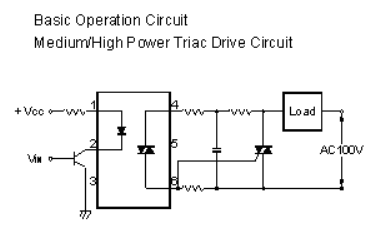

MOC3023 isolutes the mico from the triac. (so full wave will work) and the MOC3023 needs only 5mA. MOC3022 = 10mA, MOC3021 = 20mA There are many triac opto isolators. This is one I have. You can find better parts.
Point is: full wave is 2 more diodes. Less ripple on the +5 supply. Possible smaller high voltage capacitor. (add two diodes and cap 1/2 size) Now the gate current on the BIG triac does not matter.

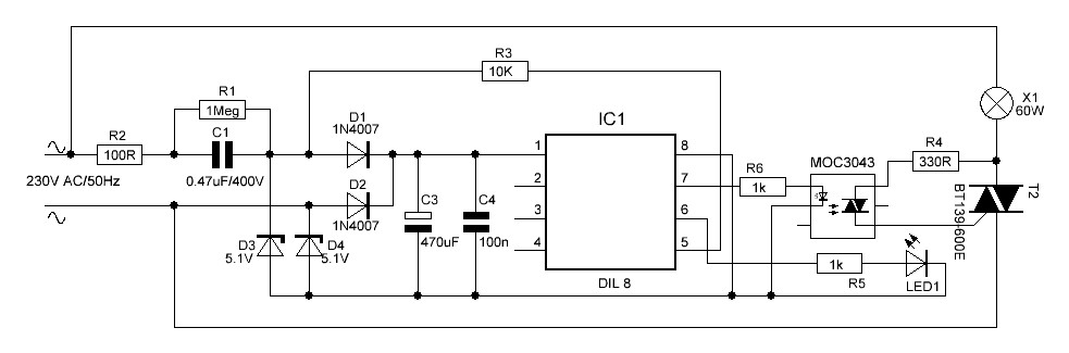

I changed the design as suggested.Used a 5mA opto-isolator.Zero Cross also taken from the low voltage side.When the Live & Neutral swap, the Zero Cross will be detect from Neutral side.I hope it won't give a problem...!!

Have you looked at the MOC3063.
It includes a zero crossing detector.
You can turn on the LED at any time but the triac will delay until the next zero crossing.
Are you doing dimming?

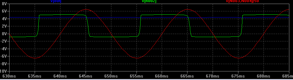

The green trace is what the micro will see for "zero detector". This is really peak detect. With a little software you can find the "zero" time.
Blue is the supply voltage.
Red is the line voltage/50, not referenced to anything.

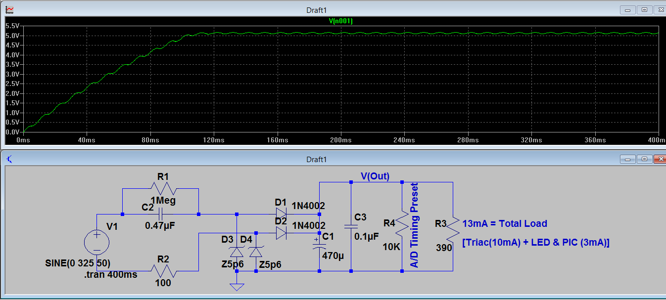

I made the full wave circuit.The problem is when using 5.1V zenner diodes the final output I got only 4.5V. I have a preset 10K which is measuring A to D value to determine the timing of this timer circuit.When the supply voltage drops below 5V the internal analog reference is varying :( I changed the zenners to 5.6V. Is it ok?
More informaton:
Which micro?
What is the "internal analog ref." voltage?
Hi
I use PIC12F675.Internal referance is 5V.I dont need much accuracy.I just need to scale the full scale A/D to 10 values.
