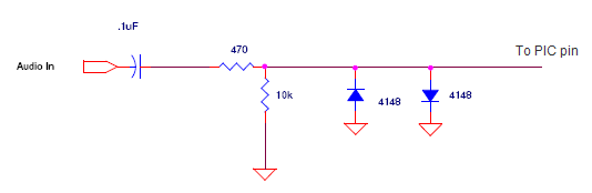

This is the input circuit to the comparator's non-inverting input:
The inverting input is tied to Vss. And the other comparator is turned off (CM2:CM0 = 101).
If I simply disable the comparator by setting CMCON = 0 the problem goes away. But of course my circuit won't work.

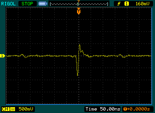

I scoped the PIC Vdd pin:

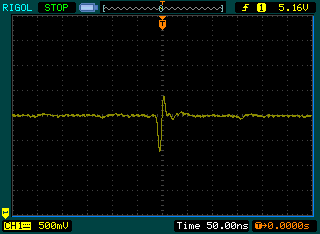

and the PIC Vss pin:
...Yeah, that spike is disconcerting. It occurs at ~ 46kHz.

The spike on the Vss pin look bigger than the one on the Vdd pin, where is the scope probe ground lead connected to the circuit?

The Vdd spike is smaller, because the probe ground lead is connected to the same side of the breadboard. If I moved the probe ground to the other side it'd probably make the Vdd spike bigger...I'm assuming. I'm not sure if the spike is an issue, since I can get rid of the clock stalling by turning off the comparator (and the spike still occurs).
