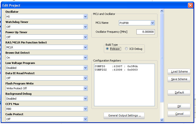

For some reason I can't seem to get PORTA.6 and PORTA.7
to be cmos outputs on my 16F88. I know these pin are
multiplexed with the oscillator module input and external
oscillator output but the data sheet says they are also
full CMOS outputs.
I'm using the internal oscillator at 8MHZ.
TRISA = %00100000 'set porta 0,1,2,3,4,6,7 as output
PORTA = %11011111 'set porta 0,1,2,3,4,6,7 high
All the other PORTA bits work fine. Is there some
configuration bit I'm missing?

Yep it's your config fuses.
Check your settings in the MPLAB config settings. There is one for RA6 and RA7 to set to I/O.
Or add & _INTRC_IO to your config settings.

On page 130 of the datasheet I found this:
CONFIG1:
bit 4, 1-0 FOSC<2:0>: Oscillator Selection bits
100 = INTRC oscillator; port I/O function on both
RA6/OSC2/CLKO pin and RA7/OSC1/CLKI pin
Looks like it might be the right bit but I can't figure
out how to set it with basic.

hmm yeh it's the CONFIG1 byte you need to change. It is not done in code though, and is independent from the OSCCON byte.
What do you use to program your PIC? If you use icprog you can change the config fuses there before burning into your PIC.
I've never used mikrobasic but try going to:
> Project > Edit Project.
Then look for _INTRC_IO under the Device Flags heading.

I did find my Configuration Registers:
CONFIG :$2007 : 0x3F6A
CONFIG2 :$200B : 0x3FFF

Try changing '0x3F6A' to '0x3F78'.
I could be wrong, but if I'm right it keeps the same config fuses for you except changes your HS oscillator (which it is currently set to) to an internal oscillator with port I/O on RA6:RA7.

Either find the box and tick _INTRC_IO or change the config word from '0x3F6A' to '0x3F78'.
Find this it's under projects and change to suite

I went back and re-read your posts again and realized
I never tried changing the config in ic-prog. Under
Oscillator there is an INTRC selection. I have to do
it every time I program the device and that worked.
Thanks to be80be I know how to edit the project configuration.
