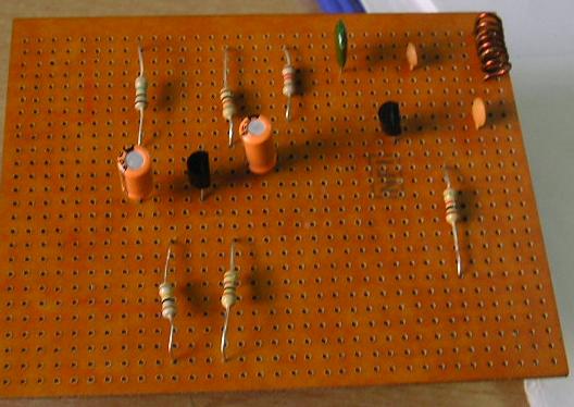

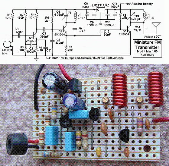

I used 1mm enamel insulated wire from a speaker's crossover network to make the tightly wound coils for my FM transmitter.
My circuit works much better than the lousy one you found. I built it compactly on strip-board.

compact design
I built it compactly on a strip-board.
I won't call it compact. It's rather seems like a beautiful placement. I can see the color codes of the resistors clearly makes it cute but placed horizontally not vertically which a compact design follows. Also a compact design won't use strip-board, a designed pcb must be used.
The board is less than 5cm long. Seems compact enough.
Vertical leads become inductors at RF.
