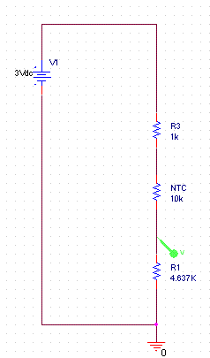

I need a design a circuit that includes NTC as an interrupt source for MCU.
When it gets warm, the MCU pin needs to receive 3.3V.
I have to power sources for the circuit, and can use one of them - 3.3v and 5v.
the MCU pin can only sink up to 4mA.
Any ideas?
Thanks!
More:
I havent picked a right NTC yet, i'd like it to be around 10Kohm, but its not a must.
I though of something like that:
untitled-gif.26575
Where R1 is the NTC.

I'd like to use resistors only, i needed to mention it in topic.

Yes - what's "warm"? What's the NTC curve look like? Without a comparator you are goofing around with poorly defined trip points over what may be a uselessly small range for that digital input port.
Blue.
Why is it a trouble for the MCU to receive analog input within its range limit?
duffy.
The NTC is NCP15XH103F03RC, its B is little above 3000. R0 is 10Kohm
Current's not the problem, it's the undefined trip point voltage between Vhi and Vlow.
Never heard of that one. Can you point to a link, or tell me how to find it? There's 57,600 results for "analog" on the site, none of the combinations I tried showed me the link.
I've used analog signals on digital pins many times for the quick and dirty A/D trick where you time an RC circuit. Never heard of an issue with the current.
In the undined region an input transistor acts analog which draws too much current. At least that is what I recall.
