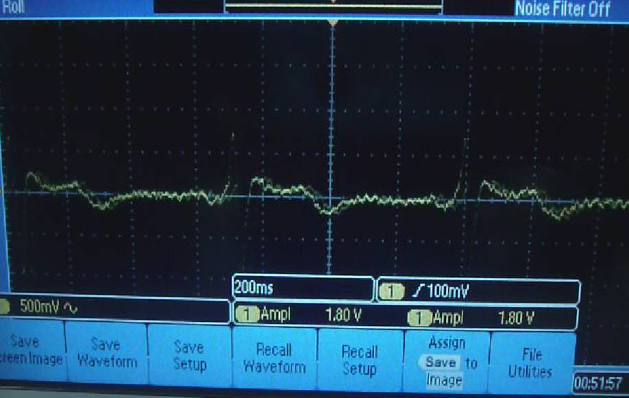

I attached the wave form obtained from the analog side. The frequency of the signal is between 0.7 Hz and 1.2 Hz depending on the age of the subject (rough average). Note that the waveform is up sided down. Pommie, the 16f88 cannot be programmed with pickit1. I want to sample 1.5 seconds long at a sampling rate where I would not lose much of the signal fidelity. Any advise on what sampling rate I should consider. I was thinking anything between 120 Hz and 300 Hz. As to Driver300 question, the output may be to RS-232 or if possible USB. Please note that I’m trying to use the things that I have e.g. Pickit1 , 16f684, Max chip for serial comm and I also found 3 of the serial SRAM that I bought a couple of weeks ago (and did not know it). I’m kind of a part junky.
