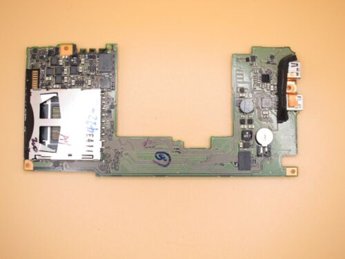

Hello, this component is from Camera olympus OM-D E-M5 Mark III, I tried to find it in shops but they said don't have a anything with numbers "1jU"
Is it Power Inductor? Or something else? Where can I get it or what could use as substitute?
It's either and inductor or a common-mode choke.
If you can work out how many wires were connected, that will tell you. If there are two ends, it was an inductor. If there were 4, it was a common mode choke.
If it was a choke, that is for noise suppression. If you bypass it by soldering wires across the ends, (near up and down in the photo) it's likely that it will work fine without the choke.

There was 5 wires, do you mean bypass it this way?

If it's 5 wires it's not a choke so I wouldn't bypass it.
I had suggested connections up-down not side to side, but with 5 wires it gets complicated and I wouldn't try.
Can you see the wire diameter / number of turns? With 5 wires it's probably a transformer. The two transistors near it are push-pull drivers of a centre-tapped primary. The centre tap is probably the central pad. The opposite two are the secondary, as a guess.
Looking at the PCB it looks more like a transformer than anything else, driven by the two devices immediately below it - it's more likely also a custom component, as most transformers are.
The only place to get one would be Olympus, who probably don't even supply to component level, and only supply to approved service agents anyway.
I doubt that Olympus would sell the transformer to anyone. They would sell the entire board.
The only other suggestion is to buy an inductor and add some extra windings.

From all this 5 pads top left one is connected to GND, is it change anything?

Not really. My guess, based on not really enough information, is that the middle pin is the supply voltage, and is the centre tap. The two transistors operate in turn to ground each end of the centre-tapped winding.
That will be transformed to the secondary. It doesn't make any real difference that one side of the secondary is earthed.
The cover on the component is probably the magnetic screening. That will make modifying a inductor to make it a transformer much more difficult.
There are a couple of OM-D M5 boards on ebay, but I cannot see the part in the photos on those - is it part of the main circuit board, or the screen or viewfinder etc??

Edit - OK, that's not a Mk3 board, I found a video showing disassembly of a Mk3 (which the OP also found).
The only option I can see to get the camera working properly is to replace the entire board, as others have said.
Using a transformer with the wrong number of turns could easily damage other parts, due to excess voltage or current.
