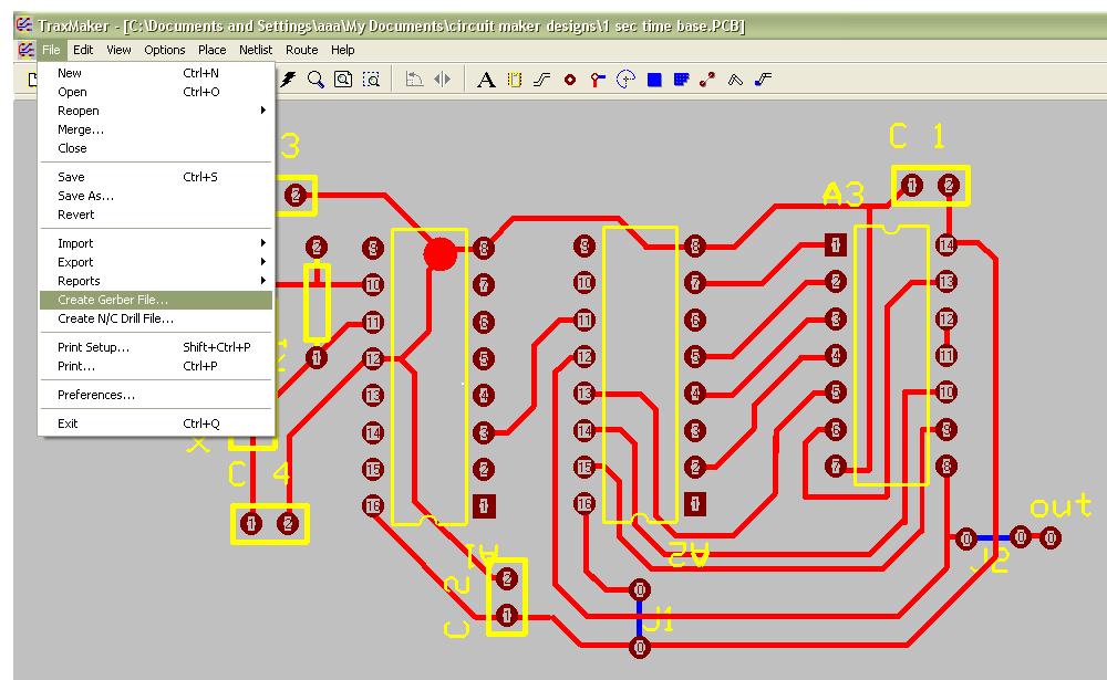

Like Ubergeek63 said, the second one is NOT a gerber file. It's just an image file of the single layer without silkscreen.
A gerber file would also not have the drill holes in it. They are stored in a seperate drill file.
you are correct about the drill holes in gerber files, its a seperate file, but if you see the layers it will look the same as in fig#2. this shows the copper layers not the drill hole.
when you generate a gerber file from a pcb drawing, all relevent files are generated and saved in one click. then you have to generate C/N drill file for holes and tool size specifications and it is also a single click.
Edit: see the attached
