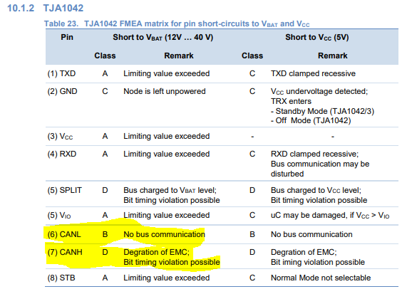

I was just trying to understand the CAN transceiver TJA1042T behavior during fault conditions:
  1. CANH short to BATT
  2. CANH short to GND
  3. CANL short to BATT
  4. CANL short to GND

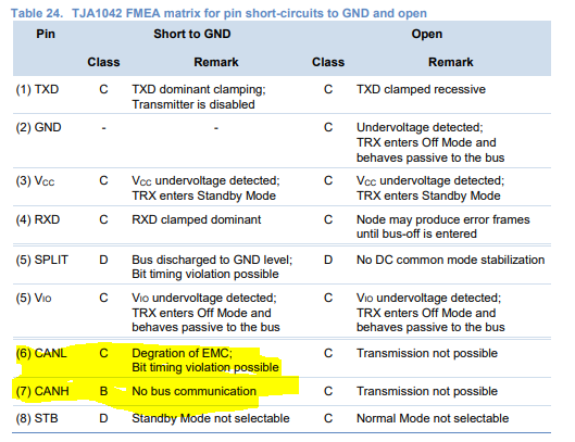

  2. During CANH short to GND, I expected the communication to stop but what I observed is that when CANH is short to GND CANL voltage level is also moving to GND during recessive state, and during dominant state the CANL is actually going negative to about -2.45V for a short duration and tries to got back to GND level ,so it's like a negative ramp signal and the RXD signal matches the TXD, the communication is still possible.

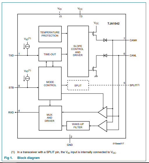

If someone could explain to me how the voltage levels of CANH and CANL were shifting in all the cases, and how the CANL signal was going negative during CANH short to GND to maintain the differential volatge to interpret '0' bit transmission.

In the application note, I found the pin FMEA for short circuit conditions as below:
One observation during my testing which contradicts the table above is the condition 2) CANH short to GND, where I've observed that communication is still possible as opposed to what is given in the table above
