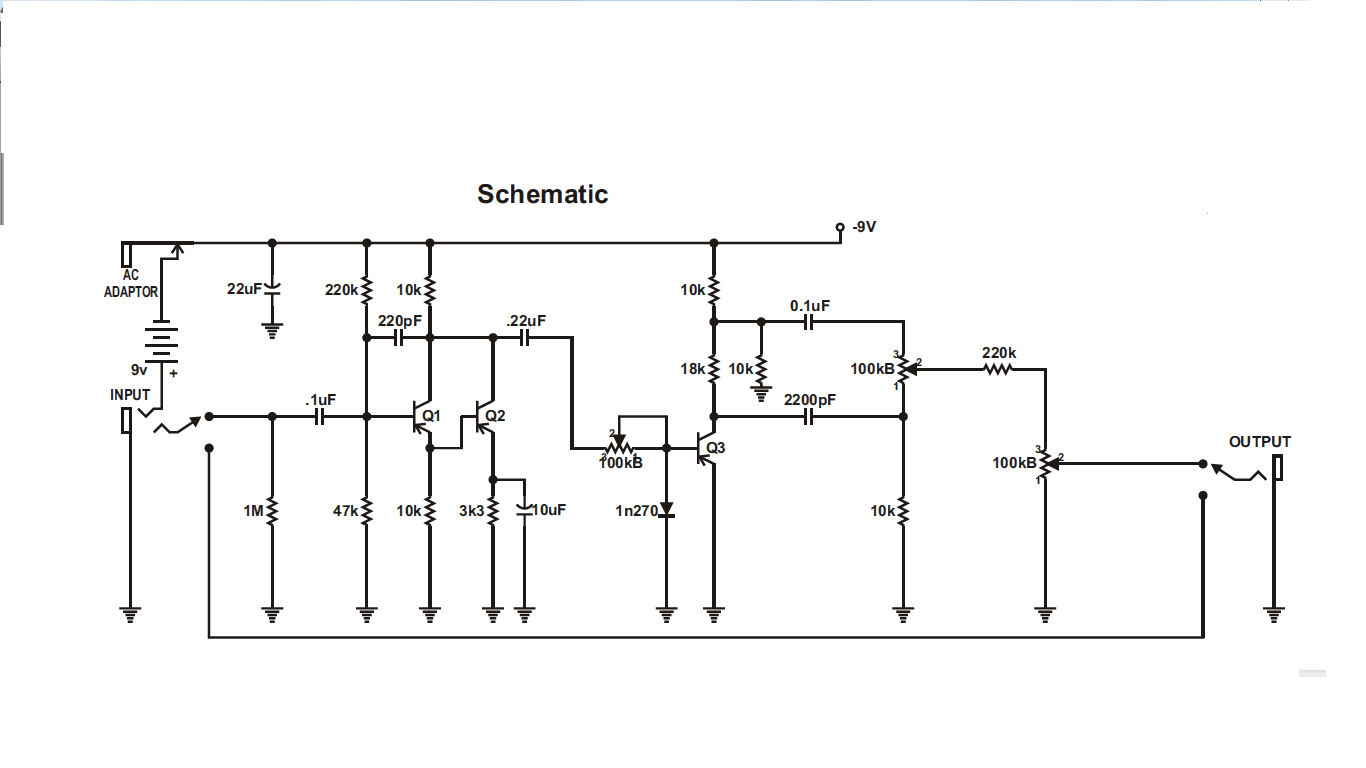

hi guys!i am trying to build a distortion pedal but im having problem on explaining the circuit flow and what does each part does.
i only know that distortion is caused by clipping nothing more.
can someone help me explain the circuit?
your help will be greatly appreciated. the circuit i used is not mine,its from tonepad.com. follow the link below for the shcematic diagram

OK...the signal from the guitar pickup comes in on transistor Q1. Q1 and Q2 are configured as a darlington pair, which has very high current gain. The 220pF between the base and collector of Q1 provides negative feedback at higher frequencies to suppress high frequency oscillation.
The output signal on the collector of Q2 hits the Fuzz knob, which controls how much of Q2's output signal gets to pass to the input at the base of Q3. Then Q3's output is fed to the tone and volume knobs. The volume knob controls how much of Q3's final output signal gets to pass to the output jack
Diode 1N270 acts as a clamp diode that clips the signal asymmetrically (the positive swing will get clipped more than the negative will).
That circuit is more of a fuzz pedal than it is an overdrive/distortion pedal. But basically the darlington pair formed by Q1 and Q2 acts as one transistor that has super high current gain to overdrive transistor Q3, which causes it to distort the signal.

Hi Xoox, in addition to what Jon Wilder said I'll take a stab at it too. The clipping will be asymmetrical which is excellent for guitar as you get 2 distinct clipping stages so depending on the amplitude (how hard to hit the strings) you can work both those stages at will, for more expressiveness. Hendrix was a master of that (he used a asymmetrical germanium fuzz unit), even between note to note he could hit some notes harder than others and be almost like he was playing two instruments at the same time.
On your schematic the clipping will be very soft, I agree with Jon that definitely looks more like a "fuzz" effect than a hard clipped "distortion" effect. It is soft because the clipping is produced by germanium transistors and a germanium diode, which have soft operating curves compared to silicon parts. Also, the diode clipper is fed through a high impedance, (100k pot) so at "low fuzz" pot setting the effect should be a very gentle clipping and not harsh at all.
