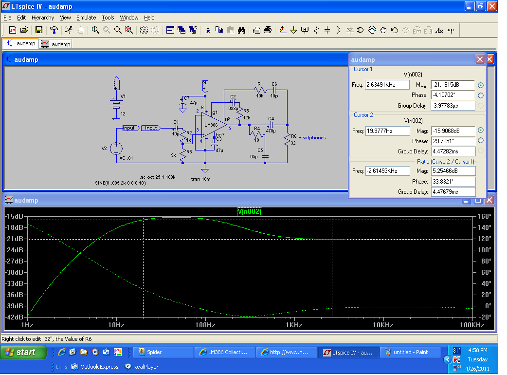

It did get me to look into Hissss. So here is a 386 circuit with anti Hissss (R1, C6) and base boost (C2, R5). R2 and R3 in the schematic represent a 10K pot with the wiper going to the amplifier. Hobbyguy, I think all the parts can be had at radio shack if you are in the US. For fun, get it working without C2 & R5 and R1 and C6. Listen to it then add each pair one at a time and share your impression of the performance change.
Hissss is audio from about 2khz to 20kHz. A tiny little 10pf capacitor does nothing at audio frequencies because it is a VHF radio filter (27MHz and higher).
If you reduce high audio frequencies so that everything sounds like your stereo with its treble tone control turned all the way down then you will reduce hissss.
That's why I ask him to compare.
If you have google google 386 hiss filter. There are several, several different values, but all above audio frequencies. Maybe you can figure it out, or if you can't we can wait for hobbyguy. If we don't hear back I'll try it out.
The ear is the final judge of quality. This isn't a super-expensive project, so my suggestion to the O.P. is to just build the damn thing already! You'll never know how good or bad it is by posting here. Try it and see how it works. If it isn't good enough, then look for something better.
They are all used for ham radio that has no high audio frequencies so the hiss filter removes all high audio frequencies.
Aw, The one I looked at had a typo. 10 pf s/b 10nf. I think I would put it back at the volume control, then the effect would be kind of like loudness.. What do you think?
