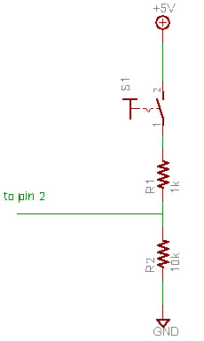

I just figurd out that the weapon itself is a closed system. When the button/trigger in the tip of the blade is pressed the wepaon becomes an open connection. This is what the scoring machine uses to detect a hit. Could I somehow convert the monostable circuit so that it is triggered on open circuit?
yes. at the input of the 555, you would want to wire the weapon switch between the input pin and +V, and put a resistor (say, 10k) between the input pin and ground.
this way, when the switch is closed, it pulls the input pin high (since the resistance is basically zero, it overwhelms the pull-down of the resistor), and when it is open, the resistor pulls the input pin low (which triggers the circuit)
I understand what you said but I cannot picture it at the moment. I will figure it out. One question that I have is the current. The weapon has a hair thin insulated wire running up a grove that is in the blade and sealed with crazy glue. Will it be able to withstand the current flow if the circuit is constantly closed?
it shouldn't be a problem... you could put a resistor in series with the switch just to be on the safe side (must be much smaller than the pull-down, such as 1k if the pull-down is a 10k) but generally speaking the 555 will draw almost no current from the wire, so the only current that will go through it is through the 10k resistor to ground. with a 5 volt supply this is only 0.5 mA which would be safe for even an incredibly thin wire.

I can't figure this out. Can you describe it again using the diagram that I have linked to as a refrence?
https://www.eleinmec.com/figures/004_02.gif
here, just replace the 10k resistor and switch in that diagram with those in this diagram:
You may get false triggering from electrical noise, present from 60 cycle fields that might interfere, also contact bounce,,but since the switch is closed mostly, a small cap of 0.1 uF of confirmation of a direct hit may be necessary. while suppressing ESD noise possibly from fencing sword contact.
The 555 uses a res*cap value or RC product constant. You need several seconds according a simple formula T=1.1*R*C where Ra ought to be around 100k max. thus for 3 seconds, C must be 27 uF approx. perhaps more so get extra parts like 33 to 47uF rated for any voltage greater than Vbat with good quality low leakage caps.
4.5V is specified as the minimum battery voltage, but if lower, it means the timing may shorten, so it might work from 3 AA's certainly 9V , then use a piezo buzzer rated for 5V to Vbat.
The LED can be an ultrabright running at 10mA easily with a current limiting R determined by (Vbat-Vf )/R usually in the range of 470'ohms.
Since the active output is low to gnd = V-, both buzzer and LED + sides go to V+ while the negative polarity of both devices are switched ON by connection to ground for 3 seconds.
