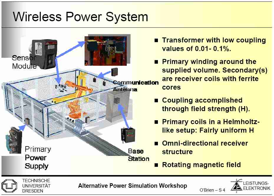

It's not an issue of whether you can charge for it. The first problem is that RF energy is not very efficient to capture with an antenna. Second is that an antenna is only exposed a miniscule amount of a non-directional broadcast. Like if you wanted to make a huge light source only 100 feet away, how much of that could you capture with a 6" solar cell? The solar cell's area can only intercept an incredibly small fraction of a percent. It's not like an antenna is a vacuum that sucks in RF energy from a large radius around it. Note that if you have one radio picking up a weak radio station, putting another radio next to it tuned to the same station does not weaken the signal. The energy captured by an antenna is so low it does not even affect signal levels very near it.
Third prob is what all the uncaptured RF energy does. It's likely that power levels required to actually *power* devices could cause significant biological effects to all living things in the serviced area. Every wire in every unshielded electronic device becomes a small antenna and it will induce such powerful levels of current that it's unlikely many modern devices could function in this field, could even be damaged.
There are cases where directional microwave energy- which we try to focus into a beam though the focusing is imperfect to say the least- can send power to a tuned microwave receiver. Not very efficient but it has been shown to be interesting because the receiver can be light and run indefinitely. However, you need a clear line-of-sight and either a fixed relationship between tx and rx or a very sophisticated tracking system. If it's a fixed tx and rx then logically just a wire would make a lot more sense. The tracking system has its uses but powering a light bulb or cell phone is not one of them. The tx can only focus on one device and you don't want to be anywhere near that beam yourself unless you're covered in tinfoil.
