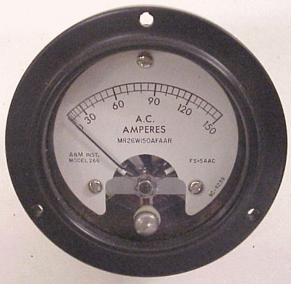

OK, let me give you an example of what I was getting at. Attached is an image of a 100 Amp AC Amp Meter. This is a typical panel and switchboard type analog meter. Remember how I mentioned full scale current? If you look closely at the meter face you will see what I mentioned where we see F/S = 5 AAC or full scale meter movement deflection is in reality 5 amps AC. The meter relies on an external shunt. Thus the scale is calibrated to read 0 to 100 amps but there is no way that little meter could actually read 100 amps of AC current as it sits.
As BrownOut points out, even a 100 watt lamp at 120 VAC would not draw quite 1 amp of current.
Additionally amp meters unlike voltmeters are placed in series with the load where a voltmeter is in parallel with the load. Now before you really start messing with mains voltages (like 120 VAC) I suggest very strongly you get familiar with how these meters are used, how they are placed in a circuit, and common safety practices. If you place a current meter like the images across a load really bad and ugly things will happen. :)
<EDIT> The pictured meter in this post is available here at a cost of about $11 USD. </EDIT>
Ron
Ron

Yeah, generally somewhere in there you will see the full scale current for the meter movement. I'll tell you what I learned in this thread. I was surprised at the prices some of the really well made analog meters are going for. Not analog panel meters like many we see today made of plastic but those metal housing well built meters. I wish I had a pile of them. :)
