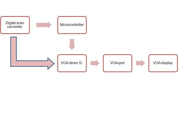

scheme
this is the scheme i have to follow

yes it is..
but it is vga to TV converter
i have to input from vga port process video and then output it via vga port.
