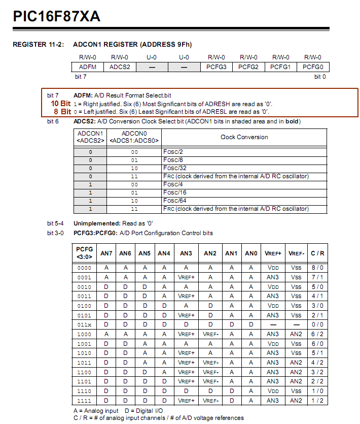

Now I’m trying to implement the knowledge I gained there, to make another ADC, but with 8bit. Is it possible using the same PIC 16F876 ?

hi aljamri,
Its doesn't work like that.
If you have a 5Vref and set the adc for 10 bit resolution you will get for a 5V adc input 5V/1023 ie approx 4.88mV /bit
If you set the adc for 8bit resolution, for a 5V adc input you will get 19.6mV/bit.
Its the resolution that changes not the voltage range...OK.?

Just an additional note to the comments made above-
The main point is that you would get rid of the two LOWEST bits, the LSBs NOT the two Highest bits, the MSBs.
This way you only lose resolution, not range. hope that helps

Do you mean it can be done just by ignoring two bits ?! or I have to set the ADC differently to get 8-bit output
That's exactly what I'm looking for, how to set ADC to 8-bit instead of 10 bit.
Morning aljamri,
Corrected.!
When set for 8bit ADC, read the ADRESH register after the conversion, value will be 0 thru 255
