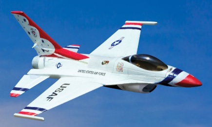

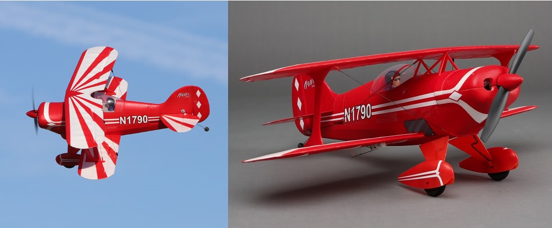

The biplane was new last year and the ducted fan jet is about 1 month old. Both use accelerometers.
