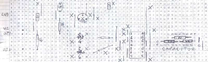

I was wondering if anyone can tell me if my wiring diagram will work. I'm mainly concerned with the components around the 4069UB, I'm convinced everything to the left of the 4069UB will be fine.
This is a view of a veraboard with the copper tracks having a left/right right/left horizontal arrangement. The capacitor has not been added because I've still to receive the component but it will be placed on the track saying capacitor with both legs on the same track, although may'be that needs to be changed.
Will the capacitor need to have both legs on different tracks? :confused:
All lines are just copper track connections to redirect current.

I think you are talking about Capacitor C1 (2.2uF). If the component is mounted on a horizontal line, the copper track between the pins of cap must be Broken.
A More serious observation-- Please see --you left the tracks between the IC pins shorted ( say between 1&14, 2&13, 3&12, 4&11, 5&10, 6&9 and 7&8). There need to be track cuts at these points also. Like this you may have to check many other locations.

The CD4069 oscillator circuit is wrong:
1) The capacitor must not be a polarized electrolytic type as shown.
2) The value of the pot and its series resistor have values much too low for CD4069 IC to drive when its supply is only 5V.
Fix the oscillator by using a 0.1uF 5% metalized film capacitor for C1, using a 50k ohms trimpot for VR1 and a 22k resistor for R2.

This is the attachment I attempted to put in my original message earlier, if anyone can be bothered with it, it would be appreciated like I said everything to the left is fine like in the original wiring diagram but I think this layout I've chosen is just exactly the same as in the link in the previous message I sent but obviously having just guessed how it could be rearranged it might be wrong. Especially with the capacitor.

In fact your pencil drawing is barely visible. I enlarged and try to understand. there can't be short circuit across a capacitor.thus it is obvious that you may have to create a break in between if the cap is mounted on a single track ., and then use jumper. please see the attached modded .png file. the blue circles are what you have cut and indicated. Green loops are what you jumpered and the red circles are what you may have to do still
A to N are all tracks and 1 to 53 are the other axis of the drilled holes.
Thanks a lot sarma I never realised I had to cut the track with resistors on the same bit of track, sorry about the quality of the drawing and thanks a lot for taking the time to at it, I feel confident now that my circuit is ready for building cheers :D, if u hadn't mentioned that it wouldn't have worked then, just wondering what the red circle at c4 is for?
I t is nothing more than component marking. Thereafter I started marking in Orange color. Sorry for the confusion caused in red marking of c4.
