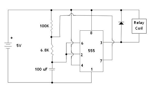

I've built a timer to trigger my cammera shutter at a fixed intervals. The camera switch was interfaced sucessfuly, and the circuit (done with a 555) worked well.

I tried changing values of the resistors, and attaching a riridulous ammount of capacitors, but I didn't reached the required intervals. Also tried with potenciometers.
As my potenciometer approach failed, I liked the idea to use a rotary switch and a set of resistors (in place of the 100K resistor shown in the circuit) to set any of this four optional values: 5 min, 10 min, 30 min, one hour.
But I still can't get the correct resistor values, even with a regulated +5V supply, I get random times everytime. I know the 555 IC on this application tends to be inprecise, due temperature and components tolerance, but the random results are unnaceptable.
I admit I'm not using the mathematic formula, just trial-and-error. Or maybe the circuit I'm using (and the way I'm modifing it) is not suitable for the application.
Any feedback would be very appreciated.

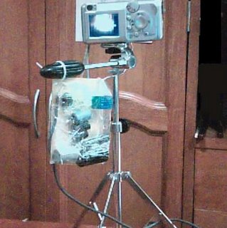

PS: I've attached a picture of the old setup, very ugly, the "tape casing" was because I ran out of time before sunrise)

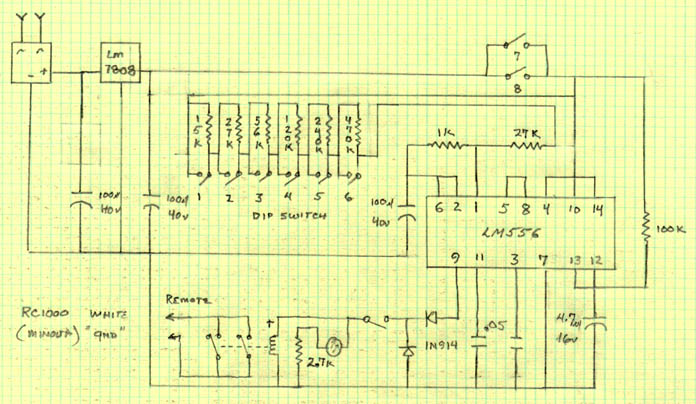

New day, new energy, I've found something:
SOURCE: **broken link removed**
He met the requeriment of the "rotary switch" I desired, but his design only lasts for few seconds, not enough for me

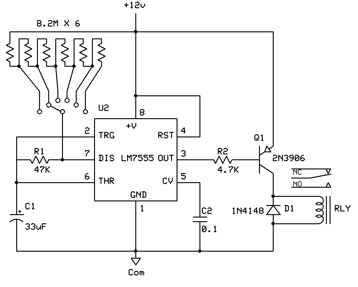

30 minutes and longer is getting outside of the reliable range for a 555. For a 5 to 30min timer: **broken link removed**
For longer times: **broken link removed**
Ron mentions a timing table that doesn't appear to be on that page, but can be found here. **broken link removed**

One last question: To make the 7555 energize the relay briefly (then de-energizing it, and start counting again) when time finishes, is enough to connect Pin 4 (reset) to +9V permanently? (like I do with 555)
OR
A single-shot 555 must be added on 7555 output, or another circuit modification is required?
OOPS! I just realized that the 7555 circuit is a monostable and will not repeat. I'll post a schematic here in a little bit that will work.
The on-time for the relay should be about 1 second.
Ken
