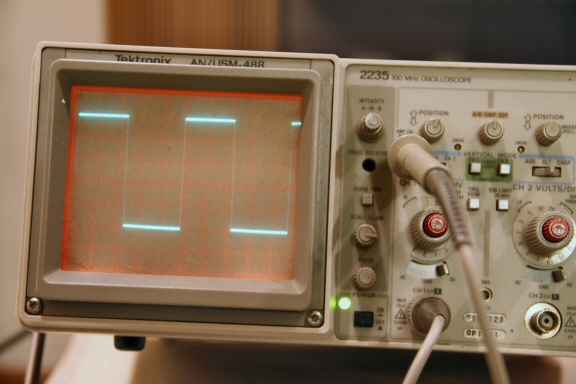

To elaborate on that, you look at the square-wave on the 'scope and adjust the compensation cap adjustment screw on the 10X probe until the top of the square-wave is flat, with neither undershoot or overshoot at the leading edge of the waveform.

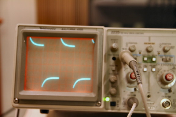

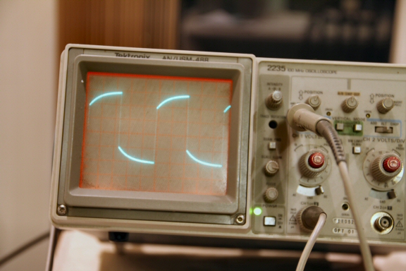

A few pictures are worth a thousand words. Below are a few images of an everyday Tek scope I use. The first image is a 10X probe connected to the scopes .5 V Pk to Pk 1 KHz square wave cal out followed by under compensated, over compensated and something like just right (actually called critical compensation if I remember correctly). :)

A correctly compensated probe will have a flat frequency response.
An under compensated probe (rounded corners) will have a low pass response, the high frequencies will be attenuated.
An over compensated probe (spiky corners) will have a high pass response, the high frequencies will be accentuated.

Well it's not actually a flaw. The vertical input channels on all scopes have vertical input compensation internal to the scopes vertical input channels. During calibration they are adjusted so the scope displays input signals as they really are. The vertical inputs will frequently have the input characteristics listed right at the channels, typically like:
1MΩ
20 pF
No two scopes will have identical characteristics. For this reason when we add a 10X or 100X probe the probe needs to be compensated to the scope's vertical input channels. This is so the probe will display an incoming waveform accurately and what it really looks like.
The reason a square wave is used frequently is because a good 1 KHz square wave is easily produced and the leading edge of a square wave contains an infinite number of odd harmonics. Plenty of high frequencies.
As Mike points out a sine wave could be used but you would need to sweep across a wide range of frequencies maintaining a constant amplitude in from the source. Sort of much more difficult.
The image I posted for under compensated shows poor high frequency response. Called high frequency attenuation. The overcompensated is responding to the high frequencies but poor low frequency response. High frequency accentuation.
Thus, 10X and 100X probes have compensation adjustments on the probe so the probe can be compensated to the individual scope channel(s). These adjustments (tweaks) are on the probes.
