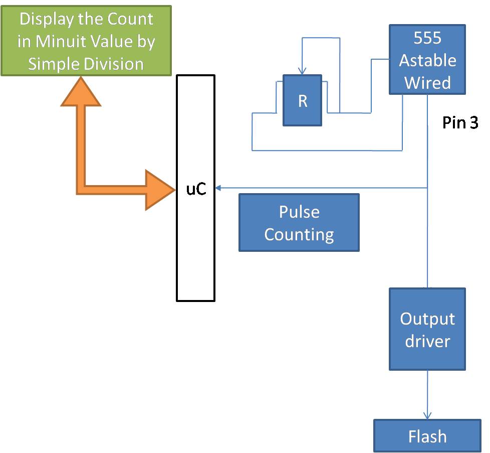

It is simple,
1 - You need to make an oscillator that can simply oscillate 1 Hz to 170 Hz by a resistive incriment / decriment. ( Simple 555 astable Multi Vibrator May enough )
2 - Use your micro controller to controll it, and interface switch with the controller.
3 - Interface different resistance with the microcontroller port that gives the voltage to the oscillator..
4 - you can add many functions with this, and the programming is going to be very simple as you are not going to set the time .
If you need to controll very accurately by Hz by Hz then tell me I will suggest something more more...!

1 Hz to 170 Hz is the range I mentioned, But This DDS is seems to have much costlier system design I feel Mr. Mike, But We have more better options rite ? Cost effective etc.....
As per the Above Blocks , Adjust the resistance and do better system....
Very Cost Effective one Rite ? Accurate , Simple....!
Why That Much Complications, use even 1.1 Hz Incriment ........

Thank you Mr Mike For your Advice. I admire you ...!
But let me Ask you, Do my design will satisfy the need or not ?
She can do much better than she can, is it so...!
I want that only.... Dear Friend......!
https://en.wikipedia.org/wiki/File:Direct_digital_synthesizer_block_diagram.png
I thought it was the DDS....!
But you are saying other type of DDS........!
I didn't know that was... Really thank you
