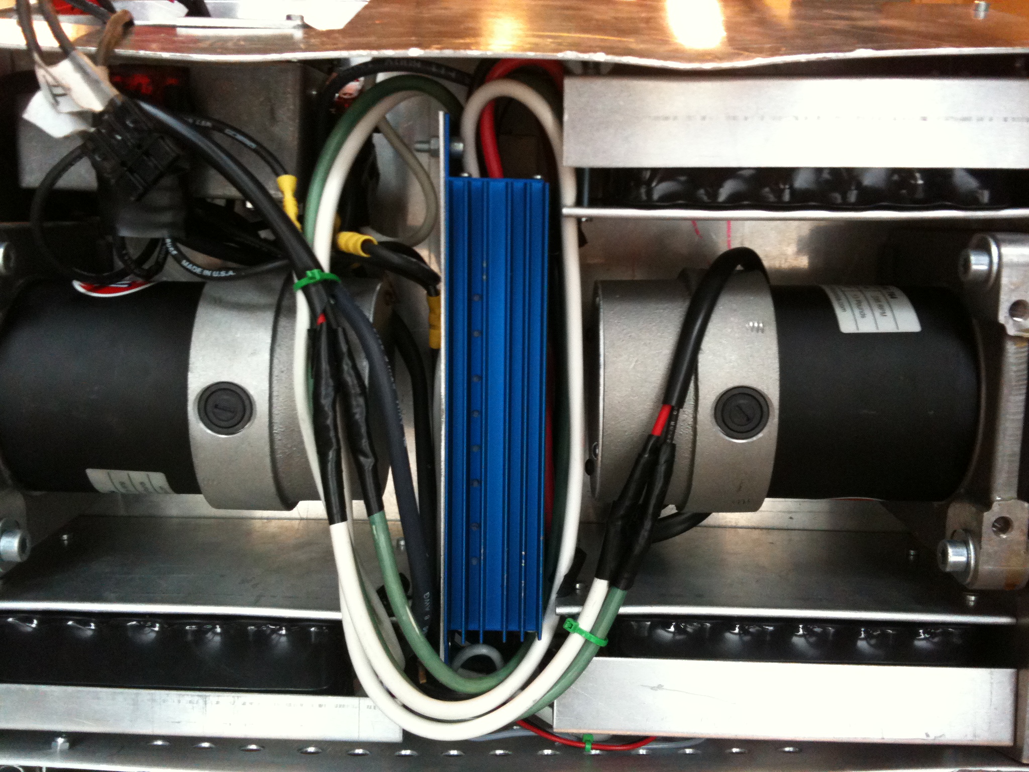

Here are two pics attached. The first pic shows the bottom side of the Segway, two NPC-T64s + the blue box which is a Roboteq AX2550. Three battery-cells in shunt at 36 V and 3300 maH each.
misterT:
Thanks! That should be achievable with the motor controller we have. :)
EDIT:
The box on the top is where the microcontroller and IMU are located. There is also a touchscreen which we will implement to display speed and configure parameters in real-time.
