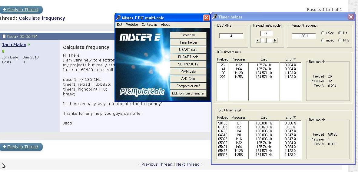

I am very new to electronics/pics and desperately need help in calculating frequency, I often need(plan) to use different frequencies for my projects but really struggle with the calculation.
I use a 16F630 in a small frequency generator.
case 1: // 136.1Hz
timer1_reload = 0xb856;
timer1_highcount = 0;
break;
Is there an easy way to calculate the frequency?
Thanks for any help you guys can offer
Jaco
You can download this free utility if it looks like what you need.
Go to Roman Black's web site and read. (Mr RB)

Jaco- You only need to change that PERIOD value in the top of the code and it will generate the frequency for you.
toggle PERIOD = (xtal / 4 / freq / 2)
so for 4MHz xtal and 136.1Hz;
PERIOD = 4000000 / 4 / 136.1 / 2
PERIOD = 3674
