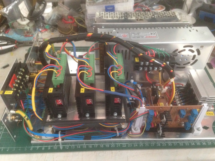

My current project .. .. ... … .
.. .. .. that's doing electronics, isn't it ?? But using a CAD schematic and a simulator has been very useful to a novice for planning his circuits and looking for and solving anomalies .. .. .. .. .. .and therefore, a good example of using and converting the results to 'real life'.

My current project
Nice CNC controller.
TY
