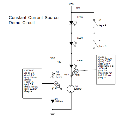

LED is an exception to this isn't it?
I think I might see your confusion. When driving multiple LED's, it is often desirable to use a constant current source so you do not need individual current limit resistors for each LED. A constant current source can be used to supply the desired current for each LED, let us say in this case 5 mA per LED. Refer to attached figure below, which I just threw together to illustrate what I mean, in fact this would be a good circuit for you to build on your app to see what I am talking about. This is not the best type of current source, but it is a good one in learning about constant current sources. If you build this circuit in your app, you will notice that as you switch in and out the LEDS, that the current remains near 6.5 mA, also note that collector voltage is changing, as this is a constant current, so ohms law dictates, that for current to remain constant, then voltage must be changing.
So my challenge to you is to construct this circuit in your nifty little app, and see what you learn from it. Let us know. P.S. I did this circuit in Multisim Blue Premium edition.
Also use any transistor you like, the 2n2222 would be a good choice.
