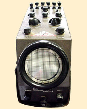

oh, come on Nigel, you've never used a Wobulator? LOL. Poor mans ( or creative mans, depending how you look at it ) spectrum analyzer, using the sweep function of a RF generator, along with the corresponding ramp signal. You end up with an RF envelope display, all connected to your 'scope. Wobulators did this on their own and were mostly used to tune IF sections, back in the day.
But I digress, and of course you are likely refering to the use of Wobulator by non english speakers when refering to a standard oscilloscope.
