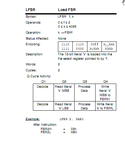

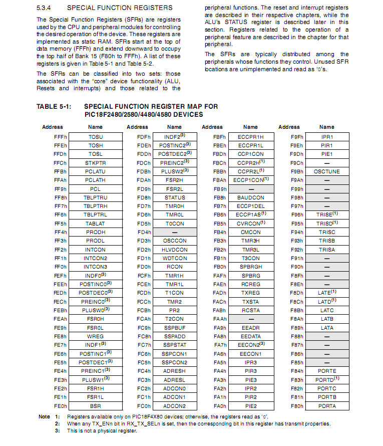

LFSR FSR0,AscBfr0 ;lsd 1st
movwf FSR0 ;pointer to ascbfr
movlw 0X05 ;digits to do
movwf Digit_Cnt
AdjLoop:
rlcf INDF0,F ;shift ASCII byte in [INDF0] 1 bit left
movlw 0X0A ;decimal 10
subwf INDF0,W ;W=[INDF0]-10
btfsc STATUS,C ;skip if no carry, its a negative result

May I know what this part does? Can't find LFSR in the instruction set and looked it up but still don't quite get what it does here.. Same with the INDF0.. Is it possible to make a flow as to what is happening for the overall codes? Never used the rlcf and rrcf instructions before but I have a rough idea of how to do it.. as for the purpose of it being in the codes as well I'm blur.. I've modified the code as you told me to and it works as desired but would love to know exactly how is it getting there.
I just looked thru the 18F4580 datasheet, I can see these Instructions.??
The code I posted is for the 18F1320, so there maybe small differences.
Look at the d/s Instruction set for RLCF and RRCF operation

Oppss sorry about that, seems I've missed it all this while.. my bad. >_< Going through the codes again.
On the 18F series, there is a lot more memory than can be addressed with a single byte.
The there are three FSR registers, FSR0, FSR1 and FSR2 that are 16 bit registers. They are the indirect addressing registers, so when the code says
rclf INDF0, F
what happens is that the register that is pointed at by FSR0 is rotated left.
For example, if FSR0 contains 0x0123, then rclf INDF0, F will rotate register 0x0123
The LFSR instruction is a single instruction that loads the FSR register with the required value.
This is wrong. The movwf instruction moves the 8 bit contents of the W register to the named register. However, FSR0 is not the name of either of the 8 bit halves of the FSR0 register. They are called FSR0L and FSR0H. The instruction as written will move the contents of the W register into register 0, depending on how the banking register is set. That is not what the writer intended.
I think that the writer intended:-
movwf FSR0L ;pointer to ascbfr
which would make a lot more sense, as there would be several AscBfr registers and the value in W would control which one was used for the following code.
