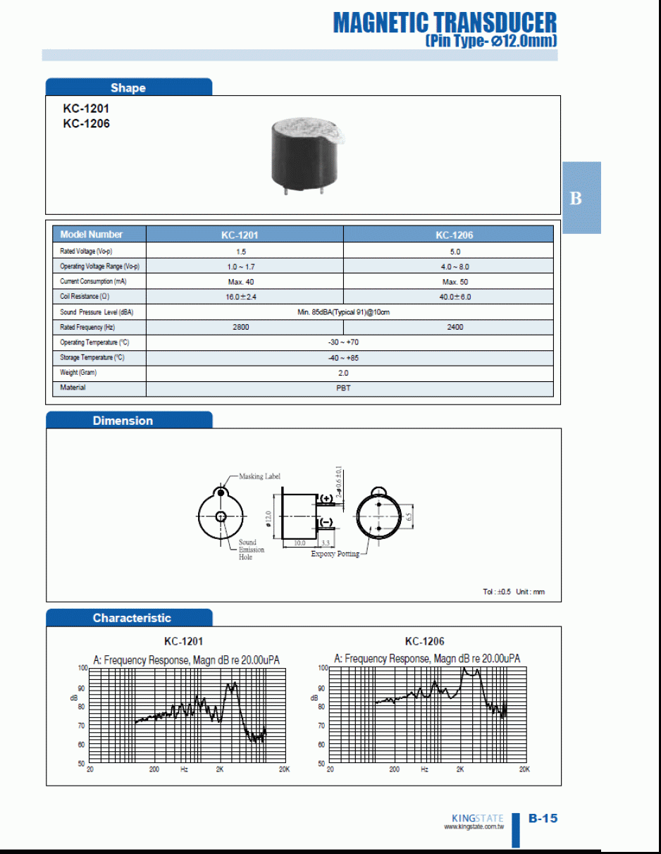

Buzzer KC1206 circuit needed
That one is a 5 volt version. Just hook 5 vdc to it and it will buzz. Pay attention to Pos + and Neg -
Here is where you can get the big datasheet.
Here is the short one.
