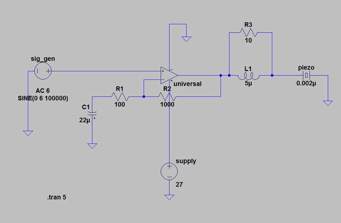

I'm looking to build a circuit using a TCA0372 opamp that will drive a piezo. I discovered LTspice earlier today and it looks excellent. So I have put the circuit into the program. I haven't put in the component values so I can't 'run' it, yet. I'm looking for some input on whether this circuit is going to work as intended. I'm a beginner at electronics so there will probably be a few mistakes.
The opamp I'm using is the TCA0372. I've attached the datasheet. It'll be configured for single supply and non inverting. The Gain bandwidth product is just enough.
The input will be from a signal generator 4V-8V , 50ohms, at 100KHz
The supply voltage 40V DC.
Output gain times 10 (20dB)
It'll be driving a piezo 2nF and impedance 100ohms, resonant frequency 100KHz.
arwesd-jpg.40184
The opamp doesn't really come with any application hints,
1) Do I have to protect the power sources with some kind of bypass?
2) Opamps aren't good at driving piezo's so I think standard practise is to use a resistor in parallel to an inductor to compensate. I'm not sure if the values are right though?
3) This opamp doesn't require a pcb layout does it? I need to build it on a breadboard if possible.
Thanks for your input,
Antknee.

Your opamp does not have its input DC biased so it will not do anything.
The feedback resistor to ground needs a series capacitor to stop the opamp from amplifying its input DC bias voltage.
Don't use a supply voltage that is the absolute maximum voltage allowed.
The opamp you selected has a low slew rate that limits its full output to about 25kHz.

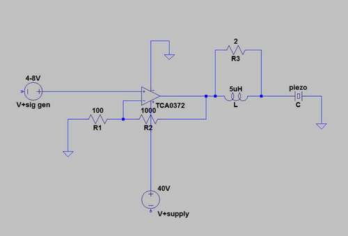

I have updated the schematic based upon the comments, thanks.
It won't run in LTspice, that isn't really a surprise! There are any number of things which could be wrong. In particular I'm not sure how much detail LTspice needs for the input source. I put in a sine wave, AC 6V and the frequency but there were some other input boxes which I didn't understand, so left empty. I also wonder what the arrow is that you get when hovering over a component, I set them all to follow the positive terminal anyhow.
That is a little annoying. I was aware of the function of slew rate but its one of the things that I never considered as a possible problem. I might try to put a square wave out of the signal generator.

Since the input is referenced to GND (i.e. the input signal swings both positive and negative with respect to GND), then you either must power the op-amp on split +/- power supplies, or some how bias the input signal halfway between GND and +27V!
You can temporarily fix your "lack of bias or split-supplies" problem by using "SINE(14 6 10K)", which will cause the +-6V sine wave to ride on top of a 14V positive offset. That will make it simulate, but you still will have to devise a suitable bias network to be used in the real world.
The "AC 6" attached to the input source is only used for .AC simulations; it has no effect whatsoever on a .TRAN simulation.
The "SINE(0 6 10K)" attached to the input source is used only for the .TRAN simulation. Since you are asking LTSpice to simulate for 5 seconds (".TRAN 5"), and since the input source is 10kHz, you are asking for LTSpice to run for 500000 cycles of the input. You do not have enough time to wait for the solution, nor enough disk space for the output file. A more reasonable request would be to simulate at most a few hundred cycles, so change it to ".TRAN 10m", i.e. simulate for 10ms or 100 cycles.

I think it might be better to use a dual supply. I decided to use a single supply for this circuit because I thought it would simplify matters. There's nothing simple in electronics is there.

Reread my previous post again. I added some more info...
Oh, and in the real world, the polarity of C1 is backwards. LTSpice doesn't care, but the real world will.

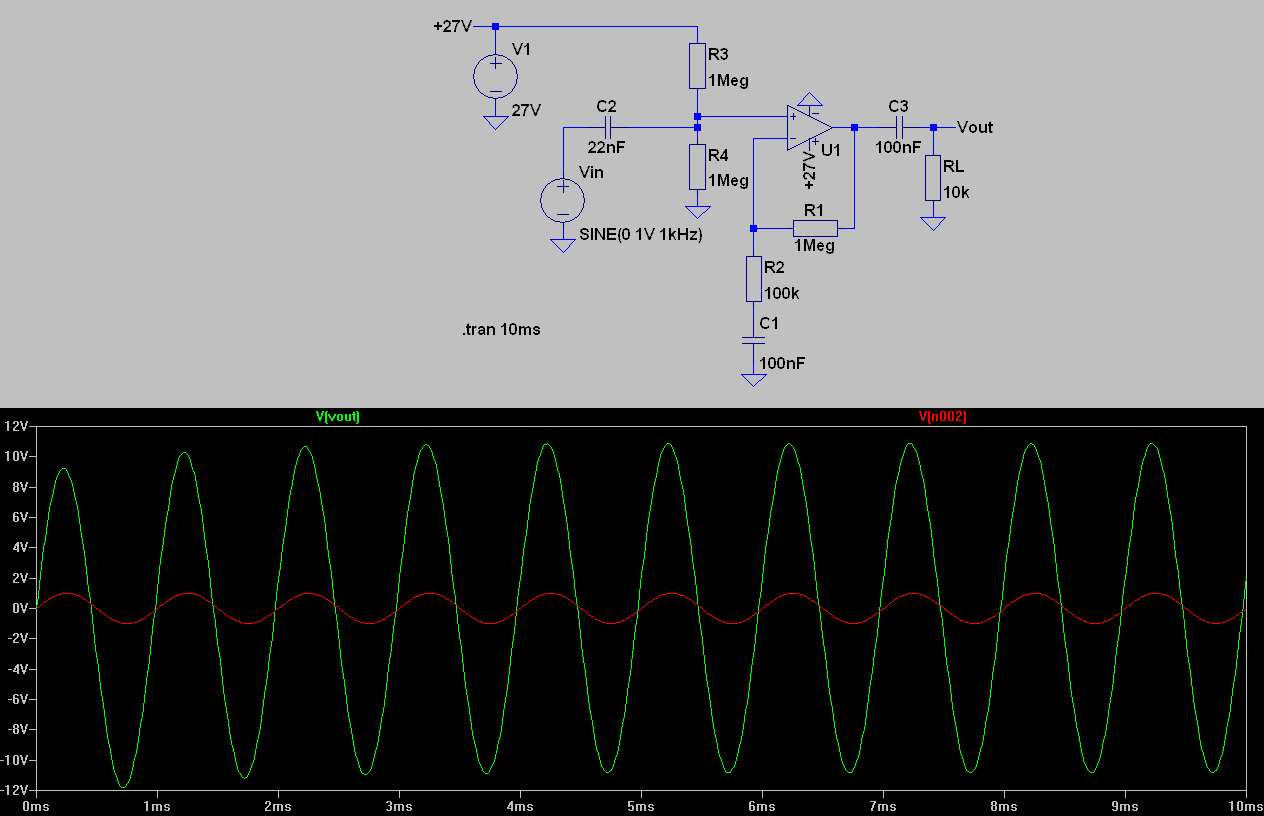

You won't be able to drive a piezo with any decent amount of power using an op-amp.
Anyway, here's how to set up a non-inverting amplifier with a gain of 11.

Using a square-wave as the input will not help the poor high frequency slew rate limiting of the opamp.
The output of the opamp cannot change its output amplitude as fast as the transistions in the high frequency so the output will consist of ramps with reduced amplitude than you want.

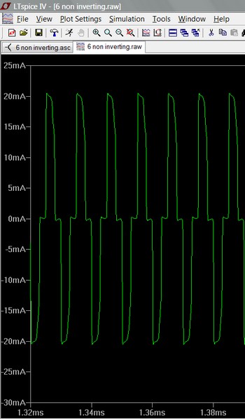

I have got a signal on the piezo. So I think the circuit is ok.

That looks like a horrible waveform, full of crossover distortion.
If all you want to do is connect a transducer to a squarewave source then why no use a half-bridge?
An op-amp isn't the right tool for the job.
It isn't the most healthy waveform I've ever seen! lol. It's a little short of a space invader though :D I don't know exactly what cross over distortion is. I will have to play with circuit and see what effect it has.
The piezo needs an inductance shunted with it for good power transfer I think. That is the principle of the humidifier circuit I have, it has never been clear to me whether I'd also have to shunt inductance when used with an amp...? So I don't think a half bridge would work.
