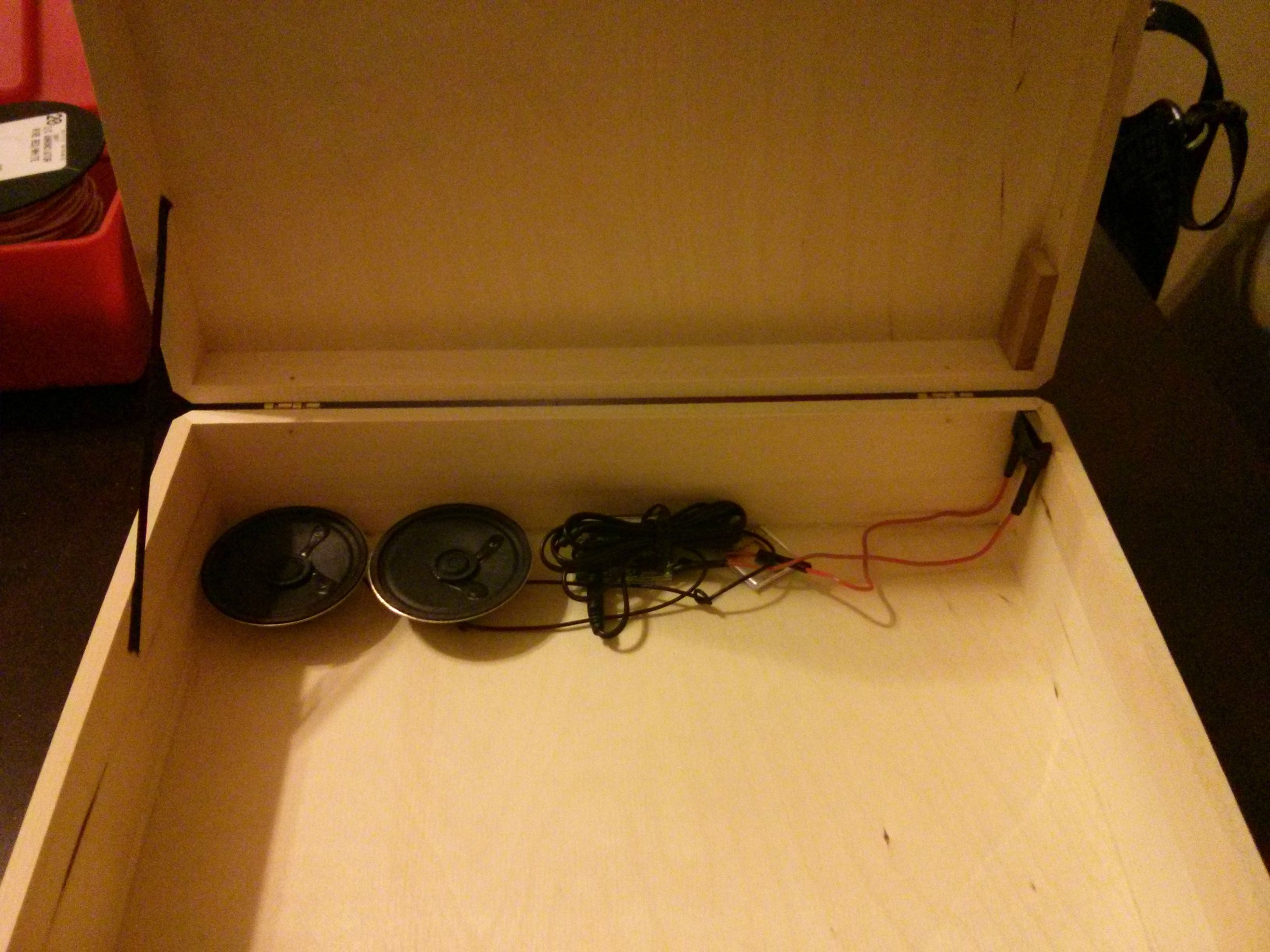

This is more or less what I'm going for:
Small speakers taken apart, the switch on the right, and the taken-apart mp3 player under the bundle of cords (not exactly your well-focused closeup jpeg, sorry cowboybob..haha)
Your little speakers need a audio power amplifier and proper enclosures. The amplifier will need a battery. Without an amplifier then they will barely be heard and without proper enclosures they will sound very tinny.
The video also did not use an audio power amplifier or proper enclosures.
The Walmart Mini Speakers have an audio power amplifier and enclosures but the amplifier is powered from a computer USB port. The speakers are so small that they will produce no bass sounds.
Thanks audioguru. Any idea if I can find something similar to those walmart speakers that don't need the USB port or power source? I'm not sure what a power amplifier is or proper enclosures, so I'm not sure what I'm looking for.
The headphones power output is much too low to drive speakers. If you connect speakers to the headphones output then if you hold the speakers directly to your ears then the sound will be at a very low level. An audio power amplifier "amplifies" the level so it is loud enough to be heard anywhere in a room. The amplifier needs a power supply or a battery.
A speaker has a cone that vibrates to make sounds. If it has no enclosure then the sounds from the rear come around and cancel the sounds from the front, especially cancelling low frequencies.
A small speaker cannot produce low frequencies anyway. An enclosure is usually sized and designed to the spec's of a speaker and must not be too small or it reduces low frequencies.
The Walmart mini speakers might be OK if you power them from a 6V battery made from four AAA or AA alkaline cells in series.

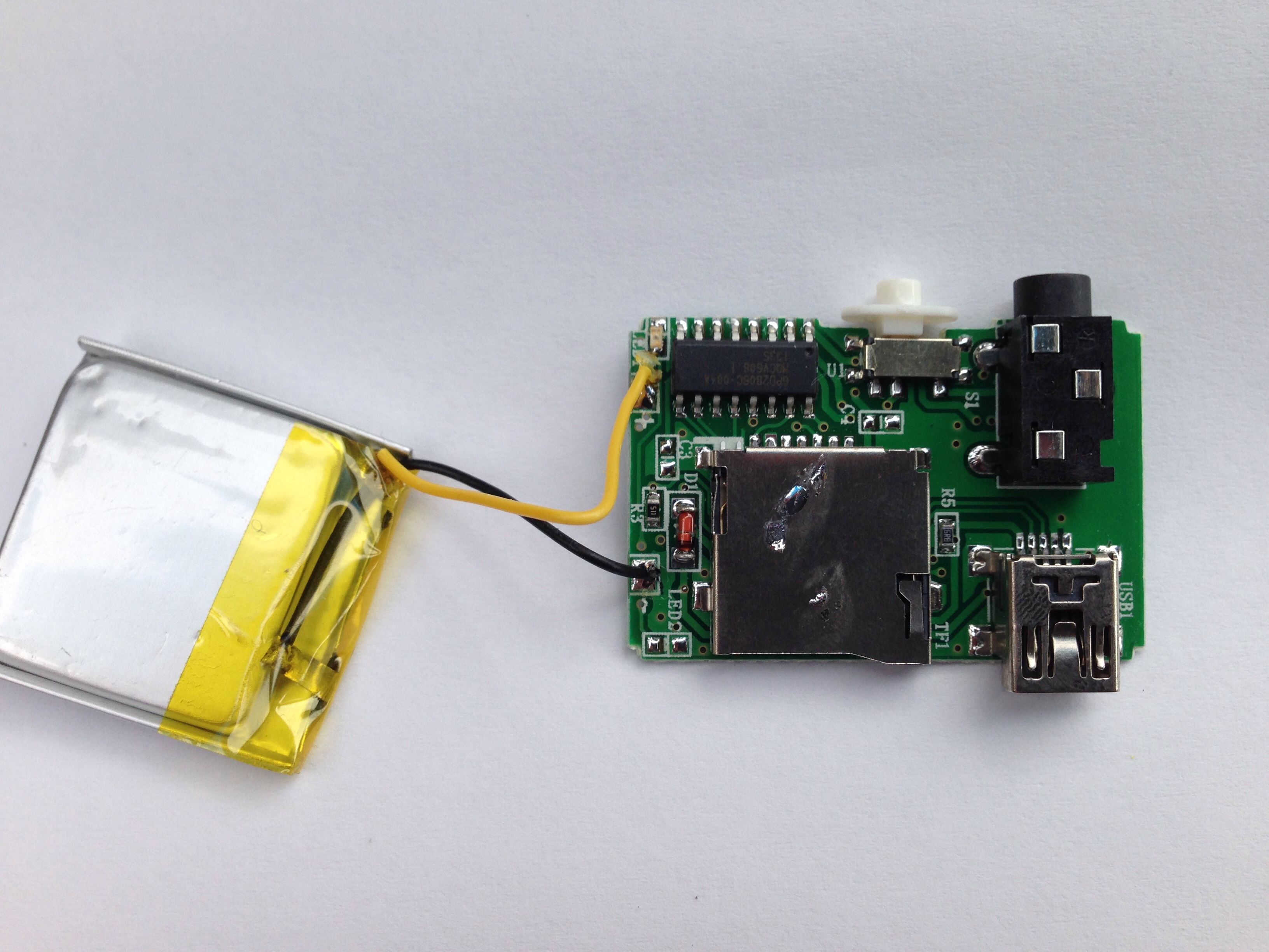

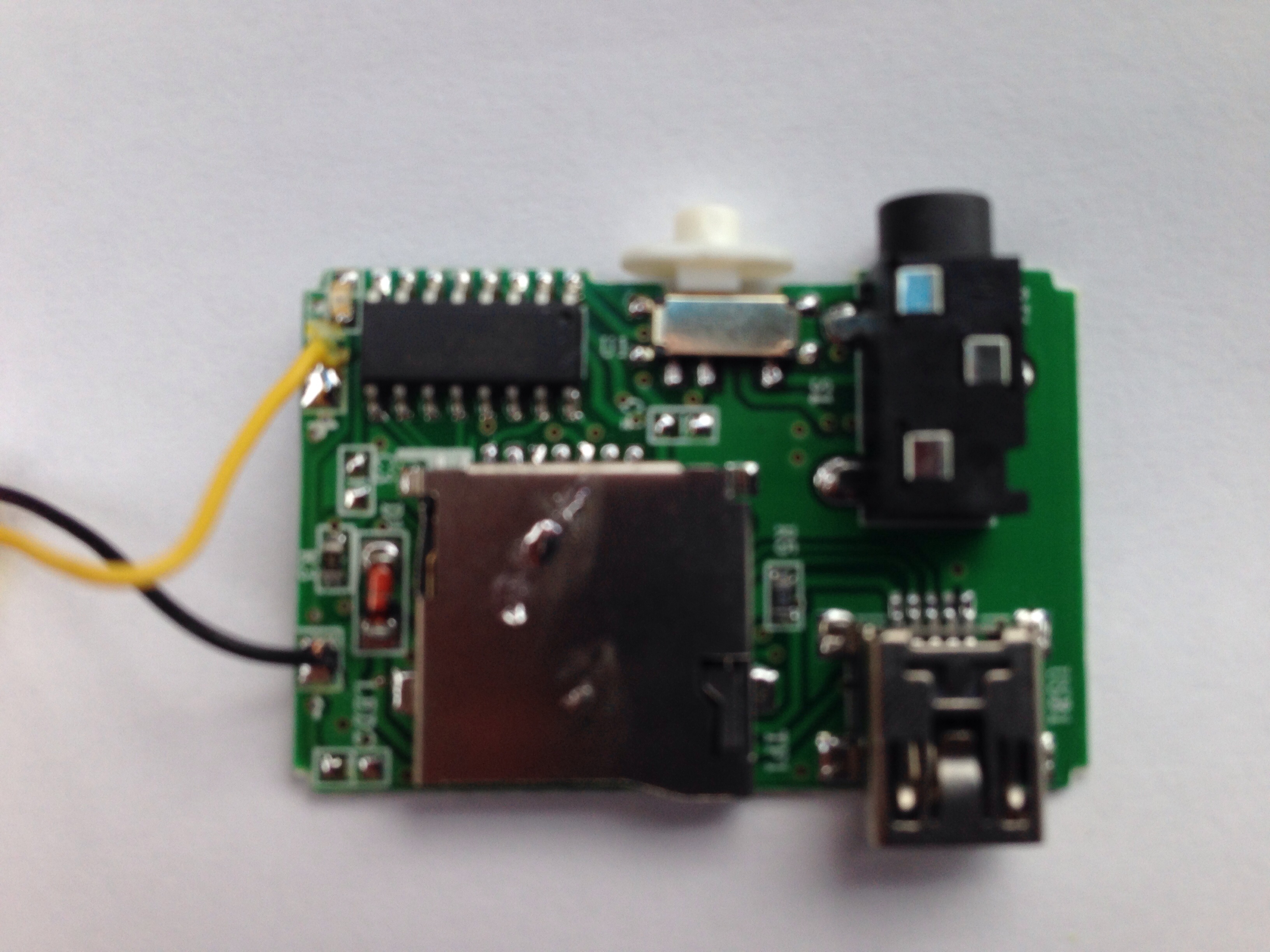

Here's a couple up close pics of the mp3 taken apart. Am I just attaching new wires to where the battery connects to the circuit board? If so...how do I go about removing them?
Any instructions here help :)
How comfortable are you with soldering techniques?
To avoid having to do any soldering on the PCB itself (which can be difficult, depending on your level of expertise), it might be best to just cut the current yellow battery line (at the red arrow in the pic) in two and splice your new switch in between them.
DON"T over-exercise the wire(s) still attached to the PCB. Doing so will weaken them and possibly break them where they attach to the PCB.
Insulate your splice work thoroughly.
That's all that's necessary. Use the existing ear buds connector for your speaker hook up.
