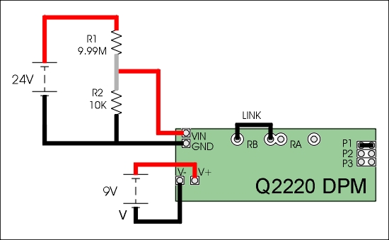

I am building an electric bicycle and I want to monitor the current draw and the battery voltage.
My intention is to use a Digital Panel Meter which can be switched from voltmeter to ammeter mode.
The bike will have two 12 Volt (sealed lead acid) batteries in series to give 24 volts (nominal).
I have purchased a 3.5 digit Digital Panel Meter (200 mV full scale deflection - uses a separate 9v battery to power the meter).
I will therefore need to use scaling resistors to give a 0-200 Volt range on the meter.
From my research I believe that this means that I need a voltage ratio of 1,000 (200 Volts divided by 200 mV).
I have drawn the attached circuit diagram based on an application example given in the instructions for the panel meter.
The values of the resistors are;
R1 – 9.99M ohm
R2 – 100K ohm
From what I can find available locally it would be impractical to achieve the 9.99M ohm value (I can only find 1M ohm and 10 M ohm resistors – which means I would need to have a clumsy series of 1M ohm and smaller value resistors).
My question therefore is;
Can I substitute a 10M ohm resistor for R1 and a 100K ohm plus a 10 ohm resistor (in series) for R2?
Using the formula;
Voltage ratio = (R1+R2)/R2, I calculate that this gives
10,000,000 + 10,000 + 10)/(10,000 + 10) = 10,010,000/10,010 = 1,000.001
Maybe this is a silly question – but if it is this close to desired ratio (and considering the error factor of 1% for the metal film resistors that are recommended) why wouldn’t the manufacturer suggest this as an alternative?

In your circuit diagram (Voltmeter for Electric Bicycle.jpg): R1=9.99M, R2=10K.
In your text: R1=9.99M, R2=100K.
Yes, you can use R1=10M and increase R2 to obtain desired voltage ratio.
Your method is OK, but you have to be more careful in calculation.
why don't you just use a trimmer pot to get the precise resistance? probably a good quality multiturn unit.
10Megs and 10k, 1% each, will give you a maximum error of 2%, if each resistor is off by the maximum tolerance and in opposite directions. Do you really need any better than that? If so, you will need to use either tighter tolerance resistors, or a pot and a reference for setting it.
How precise is the reference in the voltmeter? Keep in mind that, even with a perfect divider, you are still limited by the internal reference of the meter.

Thanks to all of you for the help so far.
Firstly, the value of R2 should be 10k ohm (pardon my typo).
Secondly, accuracy of the set up is not very important, a 2% error would be quite acceptable. The documentation for the panel meter claims an accuracy of + or - 0.5%.

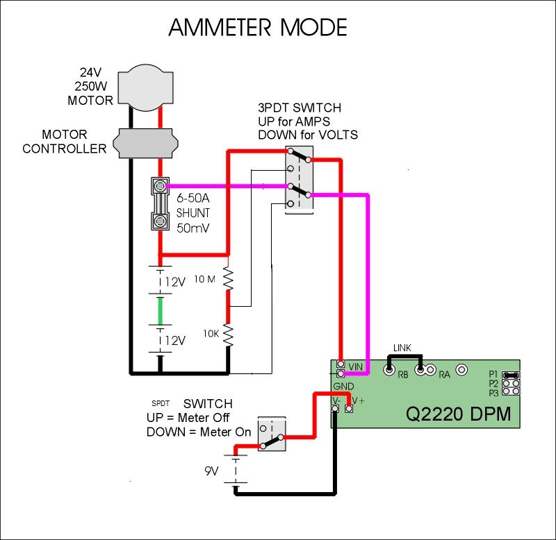

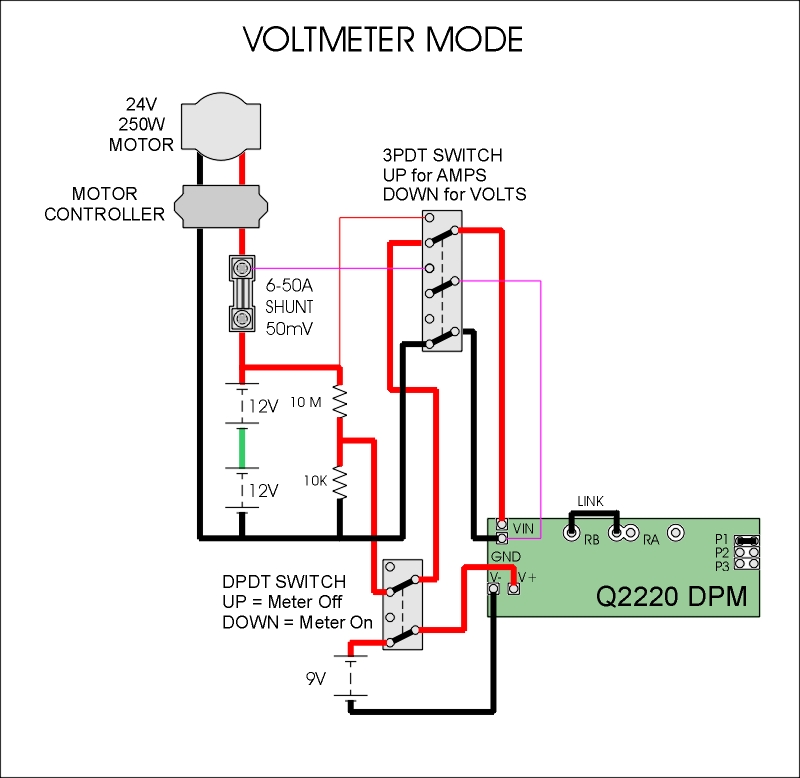

I have attached to this posting two more circuit diagrams - one showing the set up in Ammeter mode, and the other in Voltmeter mode. The active circuit in each is shown by thick lines and the inactive wires shown thin.
Please tell me if anything is wrong - I am quite good at drawing diagrams, but my electronic knowledge is pretty basic.

It's always cool to build it yourself but there is at least one meter on the market that will do what you want and more at a pretty reasonable price. I've been working to become a dealer for this product but haven't heard back from them on my status. It's worth a look. It will read 0-60 volts, 0-100 amps, and more.
Hi Ron,
Thanks for the link regarding wattage rating - that has explained it very well.
Now can anybody out there tell me if my circuit design is valid, please?

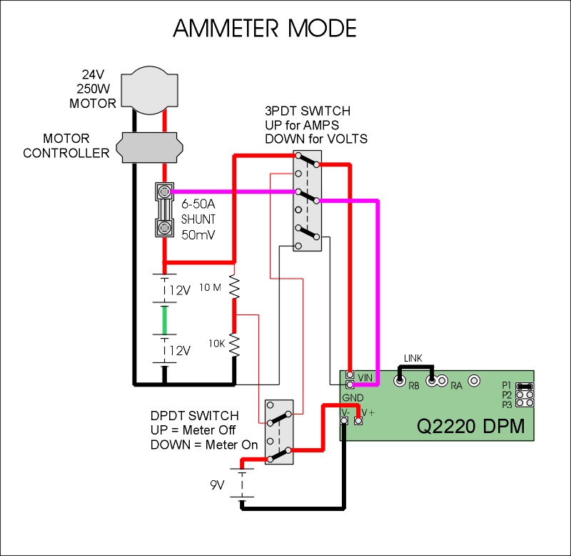

You seem to be over complicating the switching.
See my (crudely) edited version below.
