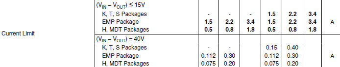

I see a graph for output current limit as a function input to output voltage differential but not one that describes output current as a function of input volatge.
It is input-output voltage differential that determines maximum available current. Here are the actual guaranteed specs. You only have two guaranteed points:
1.5A at Vin-Vout < 15V.
0.15A at VIN-VOUT = 40V
