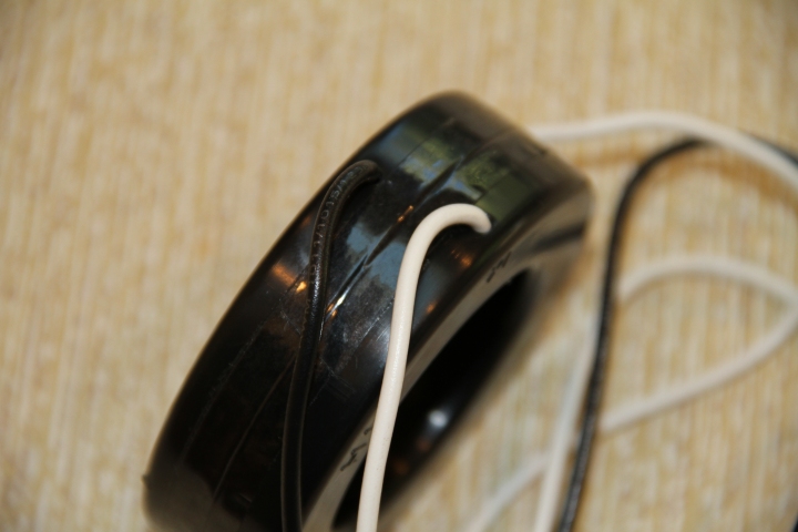

Regardless of the sensor type you choose to use there is going to be a need for some signal conditioning. If you have not see it yet in your searching this is a good read of what is involved in the calibration of a Rogowski coil.

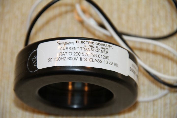

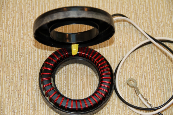

Another option is as was covered using a CT (Current Transformer) which differs from the Rogowski design in that it has an iron core that may be split or solid. If you are curious as to the inner guts of a CT I am attaching a few images. The secondary winding is a parallel pair so it looks a little strange.
Using either the Rogowski coil design or a standard CT you will still have a need for signal conditioning. The CT would need to drive into a load. This link provides some good information on basic CTs like the attached images. When using a CT we need to place real close attention to "Burden" of the load on the output.
Finally there are the hall effect devices like the Allegro model linked to earlier. These are a very good choice as all the initial signal conditioning is already done and they provide a nice analog DC voltage level that is directly proportional to the AC current being measured. Personally I would lean towards one of those devices.

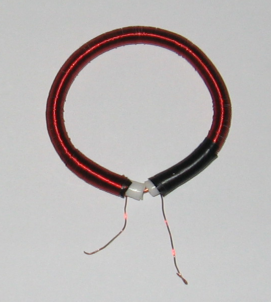

I started testing with a Rogowski and I have made a quick test:
but unfortunately feeding 300mA (powering two CFLs for a total of 37 Watts did not make the slightest difference on my scope.
Being that the hall effect device will save me lots of work and extra components, I think for around $6 it will probably be a good choice.
I should also thank RC for pointing this out as well.
Mike
Did you feed one wire or the wire pair from the CFL through the center of the coil?
Is the center coax cable conductor shorted together in the loop? I can't tell from the picture. If so, that could affect your measurement.
I fed only the common wire through the loop, I figured common or neutral wouldn't make a difference.
I had pulled out the center of the coax cable, I only inserted one inch of it to keep the two ends together.
This was build from a length of about 5.5 inch of coax cable and I used #29 or #28 magnet wire and the diameter is around 1.75 inch.
I didn't count the turns but my fingers couldn't take any more turns as I had first planned to make it 12 inches long.

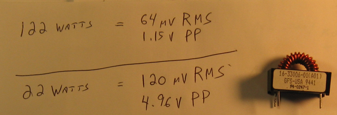

Today I went shopping to a surplus store and I was hunting for anything with a winding and a hole in it. I found this thing that looks like a choke, it has 3 pins but one doesn't seam to go anywhere. I passed my common (120VAC) feeding a 22 watts CFL and also tried adding a 100 Watts incandescent bulb for a total of 122 watts and look at the results I got in the picture:
I was expecting the opposite!
