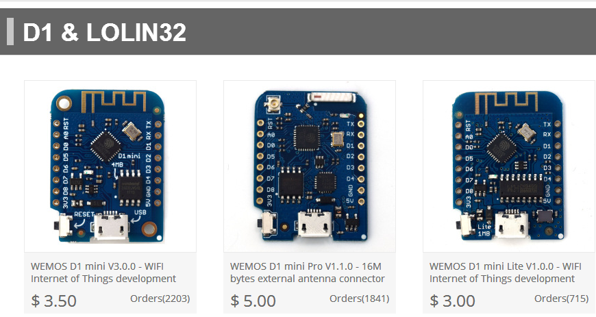

You need a wireless radio added to your list if things you need.
Think about these boards.
ADC only one input, MicroController, Wireless network, talks to Android.
