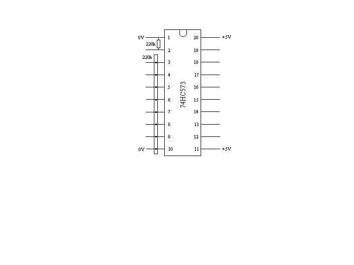

I used a 74HC573 as in the attachment.
The PIC i/o are connected to the input pins (left hand side) and I connected LEDs to the outputs.
The 220k resistor network and 220k resistor (could not buy a longer RN as the shop was out of stock) is to pull the inputs low when some or all of the PIC i/o pins are defined as inputs.
The 74HC573 is a tri state, but I've disabled the tri state to make it a straight buffer. See the data sheet for the 74HC573.

The reason I installed the buffer is to minimise the load on the PIC.
My recollection is that the PIC can source or sink 25 mA. So with the buffer driving the LEDs, I have virtually the full 25 mA to drive other devices.

I suppose... but bear in mind that the 25mA limit is per pin - and that usually the next restriction on top of that is a combined 100mA per PORT, and usually 200-300mA for the whole chip.
Not that I'm suggesting it's a good idea to push the limits, but you can probably get away with more than you might think - LED's with proper current limiting resistors are a piece of cake, though running bipolar power transistors might indeed make the buffers worthwhile depending on what you're switching.
